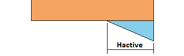

Or its probably not such a straight forward calculation, and as moment increases, loading becomes more and more eccentric and smaller and smaller area of the footing is in contact with the soil, so "If" decreases significantly until balanced state is reached, where actual If=B*Hactive3/12+B*Hacive*(H/2-Hactive/2)2
At a minimum, the forces on the footing should be balanced, no matter how you analyze it. The capacity of the footing is determined by the strength of the soil, and the size of the base plate/slab. For gravity load cases, you should aim to have resultant force stays within the kern. As the eccentricity increases, yes, as in your sketch, part of the footing can lose contact with the soil, and is considered inactive.
I did a few iterations going back and forward between my spread footing calculator and frame analysis software and found a rotational stiffness which results in a balanced solution. And seems like over 90% of the moment is handled by the eave connection and indeed very little is carried down to the foundation. And while it is still somewhat approximate method, assuming my expression for "If" is correct, results do make sense.

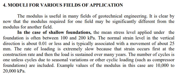

1) With respect to shallow foundations, geotechnical information is generally provided assuming:
a) that settlement rules and low moduli are conservative.
b) loads are slowly applied and sustained for long periods.
If you tell your geotech that you're designing for short duration, reversible loading in a situation where excess soil stiffness is bad, you can easily get moduli recommendations a full order of magnitude higher than those you'll get for typical, long term, settlement dominated problems.

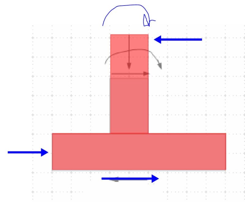

2) Be wary that, depending on your details, there may be mechanisms of base fixity other than just the soil spring thing. In places like Alberta and Wisconsin, the underside of the footing is likely to be five feet below adjacent grade level which sets up the mechanism shown below. And that mechanism will be pretty stiff right up until static soil friction is overcome.

Yes, very good point. I was taught to never count on any lateral soil resistance or soil weight while designing spread footings for PEMBs, so I naturally ignored it.
