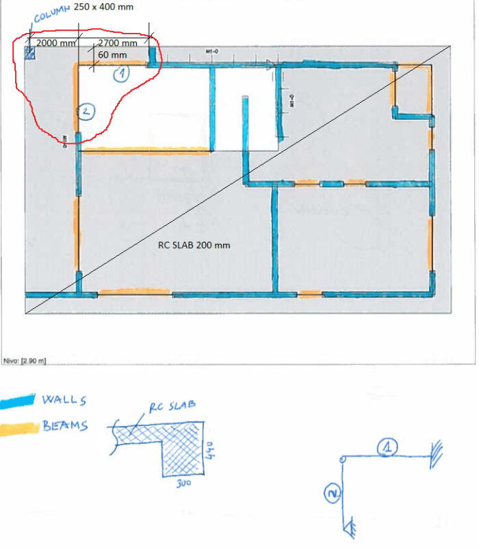

Residental building, corner beams in the ground floor.
Slab 200 mm thick.

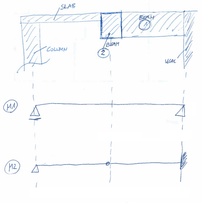

WHat is the load path in your opinion:
model M1 - acting more as simple span beam (600 x 200 mm)
model M2 - acting as cantilever beams that supports slab
I would say its closer to model M2 because its stiffer. But I get a lot reinforcement in the bottom of 600 mm wide part of the slab in my FEM software.
I'd love to see some opinions.

To get any real continuity the detailing would probably be horrific, and I wouldn't trust a residential contractor to pull it off, so I'll vote for 2. But that's here in the Eastern US where if you use anything but 2x4's the contractor has a fit.
In situations such as yours, the stiffer beam will try to act as a cantilever and less stiffer beam will try to rest on the more stiffer beam. Anyhow there will be maximum displacement at the free end of cantilever.
In your model, if the slab is not free to move at corner column then it will be trying to restrain the displacement of cantilever beam. This may be the reason why you are seeing positive bending moment at 600 wide part of slab.
Also, for a 2.7 m length, i don't think the beam depth you are providing is stiff enough to be acting like a cantilever at its full potential.

1) The fact that your slab is drawing large moments may in fact indicate that your beams are not actually stiff enough to attract load as you wish. That said, your FEM may not account for cracking etc which would massively decrease slab stiffness.
2) Even if the slab draws significant load, redistribution should be possible here. I'd take a look at the beams assuming no help from the slabs and estimate deflection at the cantilevered end. Unless that value is very small, I'd pack the surrounding slab with top and bottom reinforcement to limit crack widths.
3) I do prefer your model M2 for the primary, intended load path. Among other things, it can be detailed to resist shear with stirrups rather than just bare concrete.
4) Even if you go with M2, I would calculate an upper bound load that the slab strip path would attract and use that for your punching shear check at the corner column. The punching shear resistance at the column is bound to be brittle in nature and not capable of the same redistribution that the slab will be.

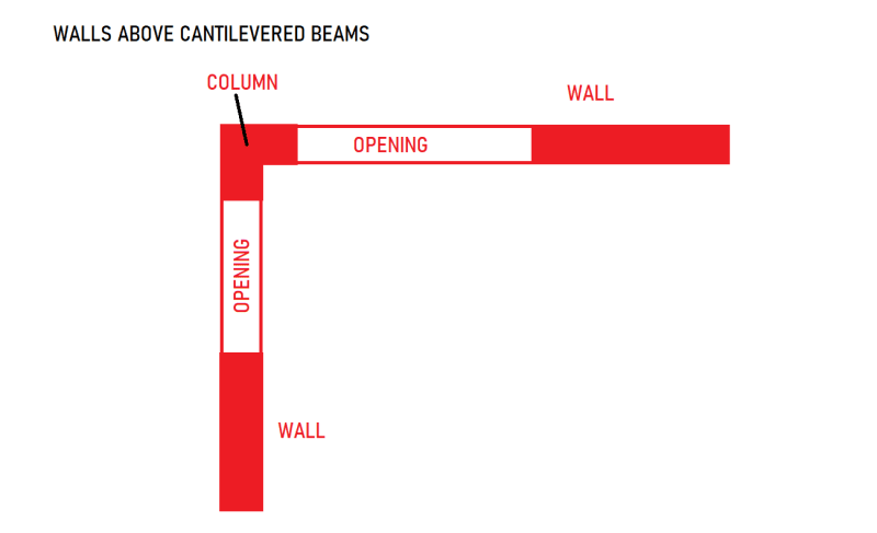

And is the cantilever supporting a wall load close to its free end?
it would be hard to make it worse - right at the end of cantilevered beams there is a column of above floor (see 1st attached image in OP)
