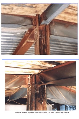

I am trying to better understand the behavior of local buckling in slender elements vs. global buckling in slender columns. I have recently seen a WT brace that is pinned-pinned at its ends and the web appears to be locally buckled (or damaged by construction) near one of the ends, roughly 18" from the gusset plate on a 30' member. I am wondering if it makes sense that this could be a local buckling failure, or if local buckling of the web would occur at midpoint of the member, where the web is the most flexible.
Does the stiffened edge of the plate change the mode shape to something that could buckle at the end, rather than the classic pinned-pinned mode shape with n=1? I don't have a picture of the brace I saw, but I do have another example of local buckling at the end of a member below.

Your claim that local buckling will occur towards the end is because torsional forces may be higher at the end and combine with compressive forces, yes?
My scenario. The LTB occurs in the beam in a half sine wave of the bottom flange. The bottom flange deflect the furthers and it moves the furthest in the centre. So you could argue that the LTB occurs in the middle of the beam. The beam twists but because it is long it twists with no or minimal plastic deformation in the centre.
However the beam is restrained from twisting at the end by its connection. This results in significant torsional stress near the connection which is relieve by plastic deformation.
But of course you've only posted one picture and that isn't even the picture of the failure you saw.

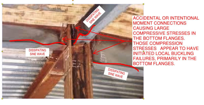

For what it's worth, when I look at your initial photo, sans-additional research, that looks like classic, bottom flange local buckling per the sketch below.

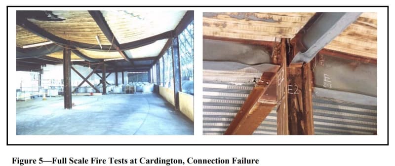

Having done some power Googling, I know realize that your photo was taken from fire testing. Same answer though as i would see things proceeding like this:
1) Heat reduces stiffness of beams at midspan such that negative moments at connections are exacerbated.
2) Exacerbated negative moments at connections produces large bottom flange compression stresses at connections.
3) Large bottom flange compression stresses at connections produces local bottom flange buckling adjacent to connections.
So the same answer, just with a very particular cause. The bottom flanges may also have buckled prematurely as a result of the heat reducing their stiffnesses locally.
Looks like the same building. A full scale fire test...well, that explains it!

Thanks Kookt. I had found numerous references to this photo and similar in many postings and presentations. Though very few of them acknowledged that the photo was a fire test. That indeed changes everything!
