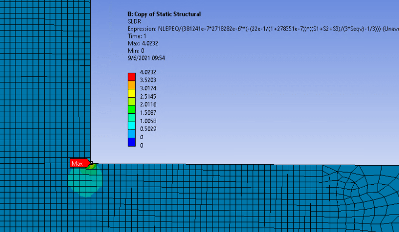

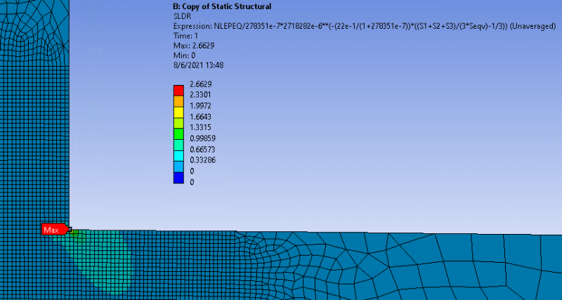

Let me explain with a simple example. I have run several simulations of a simple 2D model to avoid the large computational costs of modeling the nozzle for "investigation purposes". The following is an image of said model:

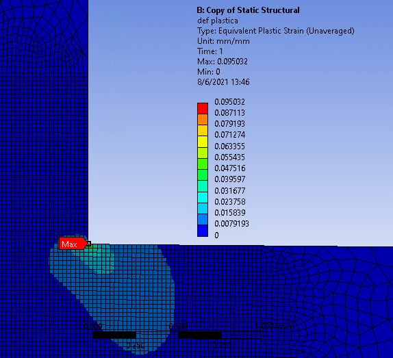

the following images shows the Plastic strain and the SLDR respectively:
Plastic strain (zoom in the zone of interest)
SLDR

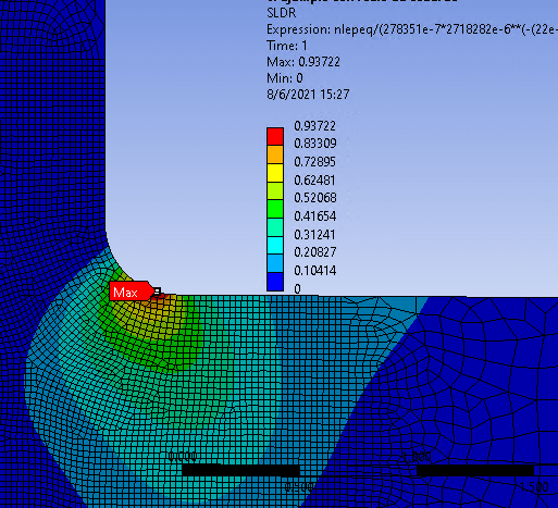

As you can see, there is a zone with SLDR values greater than 1. So i modeled a 0.1 and 0.2 mm raidus but still the SLDR was greater than 1 there. Only with a 0.3 mm radius the SLDR was greater than 1 at each point.
My conclusion is that, when analyzing local failure, modeling the fillet radius is a must, otherwise you can´t be sure that he criteria is satisfied near the weld edges.

FYI, the following image shows the SLDR of the exat same model with the only difference of a 0.3 mm radius.
Your uniaxial strain limit is too low by a factor of 10.

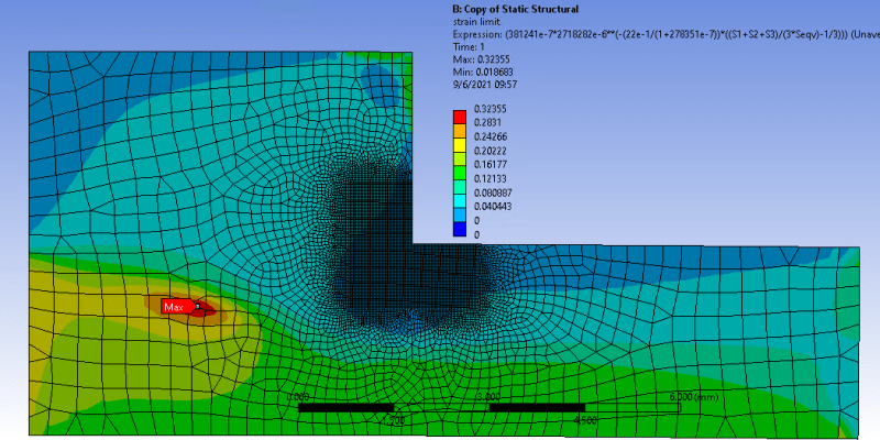

updated results:
SLDR
Plastic strains
Strain limit:
Now i see what you mean, i´ve corrected the value of uniaxial limit strain and the SLDR is below 1 everywhere. thanks for the correction. However, don´t you consider that generally speaking one needs to model the radius? otherwise, the strains results there are not real at all.
