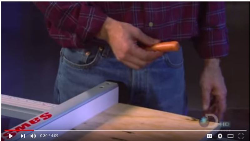

There are table saws that stop when you stick your finger in the blade. I am not sure this is good for the table saw. I am not willing to test one.
JHG
I'm not sure the blade is damaged. The blade stops by jamming a soft aluminum wedge into it. I use table saws to cut aluminum all the time, it's not a problem for the blade. The Saw Stop unit is a one-and-done device however.
j, the blade is usually damaged in the process. Broken teeth and the like... teeth can be brazed back on, but the integrity of the main disk is then in question after such a shock.
Dan - Owner
URL]
The real question is however, why is this guy always trying to cut his hotdogs with a table saw when a knife works better?
And hey, nice camera work!
I don't understand why the blade drops from that movie. The movie doesn't show it dropping only the soft-stopper being launched into it and its rotation being arrested.

Conservation of angular momentum and a compliant mount that releases the locking support that locates the exposed blade.
Now I'm been down the Sawstop rabbit hole. Lots of anger and dismay about that company for their legal dealings.
Keith,
Activation of the capture mechanism releases the axle, allowing the blade (and mechanism) to drop from the table. I cannot recall if there is a spring, as well, but the blade drops quickly, so I imagine there is.
