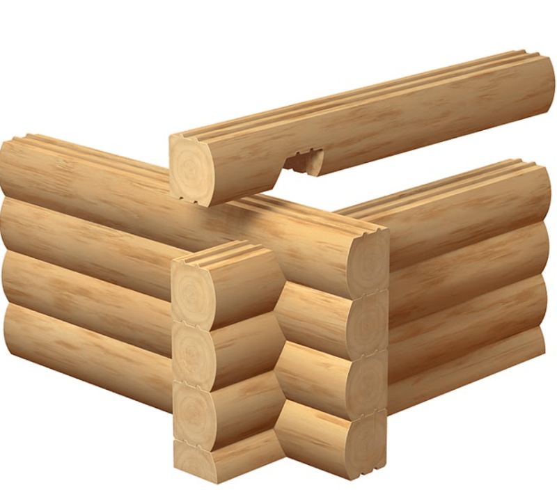

Can you illustrate or describe the interlocking somehow? Hopefully it's not just what's shown below since, in the absence of adhesive, that would almost encourage shear slip. Almost like shear friction in reverse.
In those cases adhesive is absolutely required. I'm saying the nature of the interlock is such that you have lots of surface area to achieve the bond. The heavily processed joints make for reliable contact surfaces as opposed to hollowing out the bottom of a log with a curved draw knife.
To achieve composite action, you need both a clean and smooth bond surface, if attempting to bond in the field. I would say that neither of those criteria would be met on a typical log home construction site, and as such, I would strongly caution against calculating member strength/stiffness based upon composite action.
