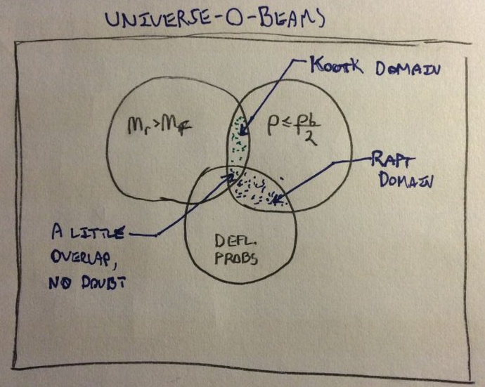

I feel as though we are telling two different stories here:
The KootK/Fanella Story
Flexural members proportioned such that flexural reinforcement is kept within a reasonable range seldom have deflection issues.
The rapt/IDS Story
Deflection calculations for lightly reinforced members can often be inaccurate and/or un-conservative.
I believe both of these stories to be generally true and feel that they are not mutually exclusive in any way.
Applied to conventional flexural members, the 0.5_rho_b business is essentially just an indirect way of encouraging the use of appropriately deep members. And, surely, we don't need to argue about whether or not structural depth is a good thing when it comes to limiting deflections? Right? Or does structural depth also not "have any relevance" when it comes to deflection control?

You may be erroneously assuming that the domain of consideration here is lightly reinforced members. It's not. The domain here is members that are lightly reinforced AND properly designed for flexure. There's a significant difference there.
With both of those criterion considered in tandem, the steel ratio logic does require a depth increase if one is even remotely interested in efficiency. This is because of the following relationship in which bending resistance varies with the square of depth:
So am I, and I presume rapt is too. Why would we concern ourselves with sections that didn't work for flexure?
I have no idea IDS. You guys really haven't given me much to work with here and I'm not clairvoyant. So far, I've provided anecdotes, a reference, an intuitive behavioural explanation, a mental experiment, and some math to support my claim. In contrast, you and rapt have weighed in with:
A) you don't like my idea and;
B) you know of some lightly reinforced members with deflection problems.
In the interest of debate parity, I'd love some additional info:
1) were the offending slabs properly designed for moment?
2) were the perceived deflection issues field problems or analytical shortcomings?
3) to what do you attribute the tendency for deflection issues in lightly reinforced members?
4) why are simplified deflection checks in AU unconservative for light reinforcing?
5) do you know of any publications that expand upon your concerns?

Well that's a pretty blinkered account of who has provided what, but never mind, I'll answer your questions anyway:
Yes. In fact the flexural design was satisfactory for the maximum moments occurring during construction, and also completed structure + live load, which are of the order of double the dead load only moment.
Construction was in accordance with specified requirements; so it's an analysis problem
Codes provide rules for "tension stiffening" after concrete cracking, but these rules tend to be un-conservative at moments just above cracking, and shrinkage effects tend to reduce the cracking moment to well below the value given by codes. Differential temperature can also have a significant effect.
Because our code requirements are based on those in ACI 318. The Eurocode rules work better.
Also the projects I have in mind are not just Australia. Also UK (worst case), Middle East, and USA and Canada.
Yes lots. Many papers by RI Gilbert, a fairly recent book by Gilbert and Ranzi, quite a bit around 2005 from Beeby, also just found this paper from some other Australian guy:

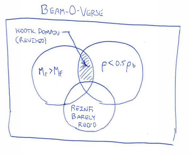

Now I see that you guys aren't concerned about lightly reinforced members, you're concerned about very lightly reinforced members. I guess another ride-along assumption in the 0.5_rho_b check might be that it only applies to members that actually require significant flexural reinforcing. I'll revise the domain as shown below which should still permit a fairly wide range of applicability.

rapt said:
If you are going to control it all by adjusting depth, then there must be an appropriate width that should be used. What is it?
It would be whatever it takes to resist the moment in conjunction with the selected depth.
rapt said:
Though not economical, width can be used to control the steel ratio to suit your initial requirement of limiting the steel ratio to less that .5.
Sure, one could go out of their way to produce a horrendously inefficient beam for which the 0.5_rho_b check would be unsuitable. As I said above, however, I don't see rare exceptions to a rule of thumb as being valid justification for wholesale abandonment of the rule of thumb. It's also important to remember that I'm a fairly capable engineer/human and it's not as though I'm putting my brain on ice while I'm performing these checks. If I see something stupid, I'll flag it as stupid no matter what my rule thumb tells me.
rapt said:
The paper you quoted a section out of required a steel ratio = .5. NOT <= .5
Is there any doubt in your mind that was a misprint? There's not a shred of doubt in my mind. It's hard to imagine that Dr. Fanella would intend for us to be designing all of our beams to exactly 0.5_rho_b.
rapt said:
Our argument is that members with significantly lower steel ratios than .5 often have deflection problems, even if designed to the simplified code deflection rules (not simple span/depth ratios which should be removed from all codes).
I certainly accept that argument and have learned a good deal about it through the course of this discussion and my related Googling. That said, I still do not accept the notion that reinforcement ratio is an irrelevant parameter when it comes to assessing deflection. Unless I have misread our discussion woefully, it seems to me that we agree that reinforcement ratio checks will correlate well with acceptable performance over a fairly broad range of application.
