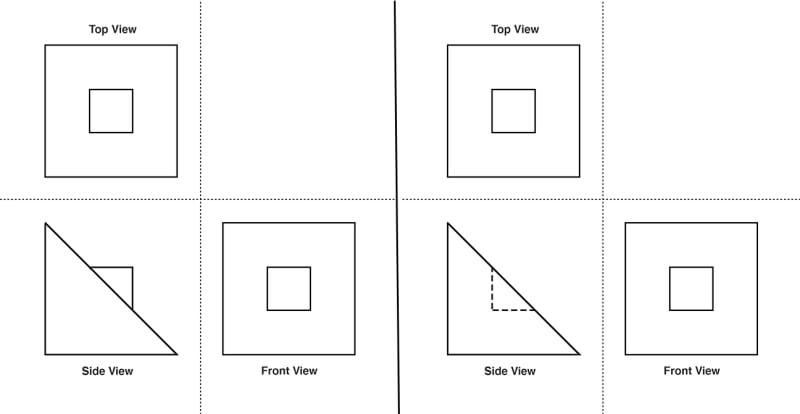

Its a cube with a 45 degree cut surface and a small cube projecting off the center of that surface.
Actually there are TWO correct answers, and I would expect a candidate to see BOTH of them.

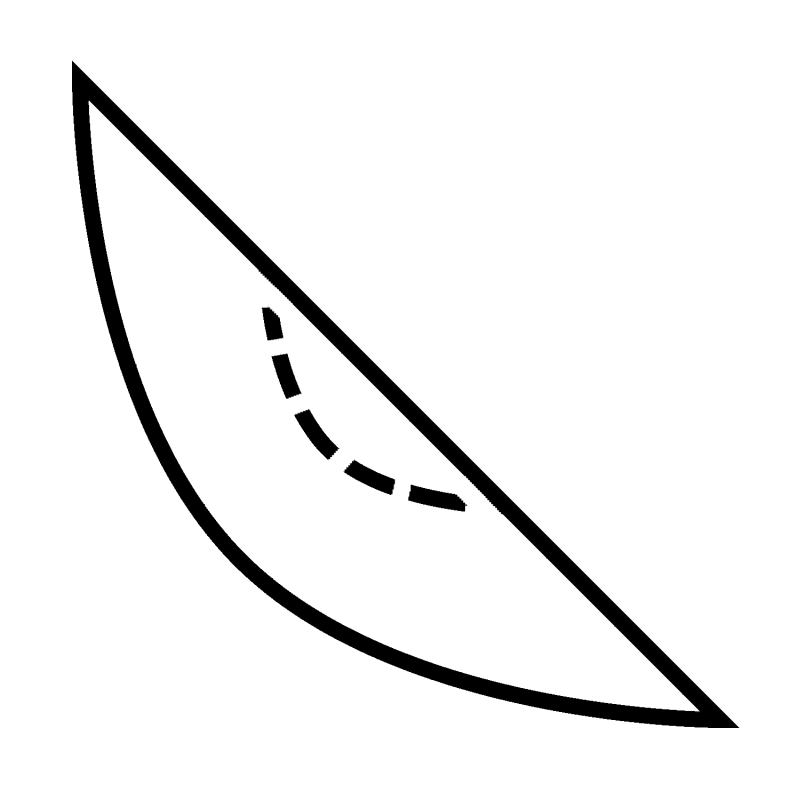

There are likely many more than 2, like whole families. It could also be an curved surface.
This was my first thought. Am I missing something?

All visible and hidden edges are properly represented in BOTH the Top and Front Views of the sample Drawing.

Here are the two solutions which have been traditionally offered when confronted with this 'test':

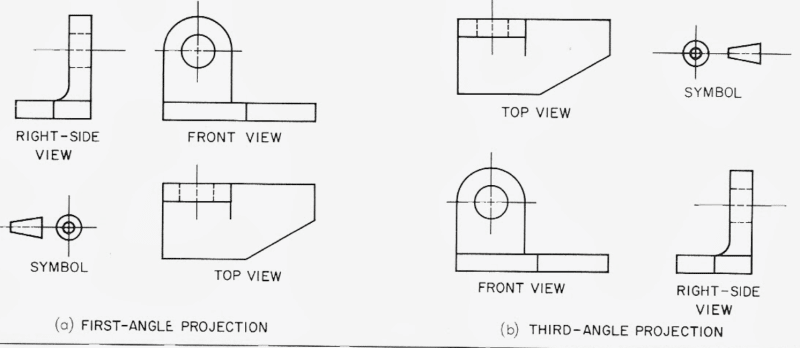

Well, If John R. Baker is using 3rd angle projection, I would say that the views are wrong.
The front view is below the top view. The right side view is to the right of the front view.
