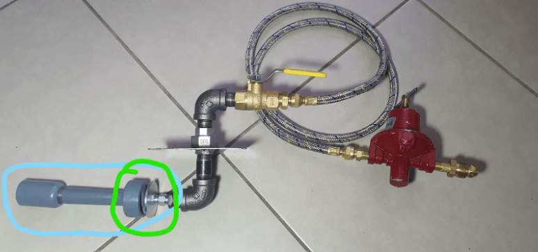

Hi all,
I’ve been scouring the internet and have asked multiple hardware stores about a burner (circled in blue) I’m trying to find and have had 0 luck.
I want one with the same “input type” (circled in green).
If anyone knows where I could purchase this burner or a better place to ask about it, I’ll give you a cookie.
The picture is from my research partner in Guatemala.
If interested, details about the research project are below.
Research Project: We are attempting to find the optimal temperature and CFM to dry Cardamom beans with propane. The current fuel source used in Guatemala is wood. The use rate of wood is greater than the replacement rate, so if this continues they will eventually have no more wood to use.

Check ceramic kiln suppliers. That's the most common configuration I see in that service.

Seems like the problem is about drying the beans during the rainy season, so no sunshine - it appears to be a crop that is both valuable and ecologically damaging, not including cutting down the forest for fuel after clearing it out to plant cardamom in the first place.
Anyway, the device appears to be designed for raku ceramic work - raku burner. I don't see any advantage to it over the conventional gas burner designs for the purposes of drying beans.
