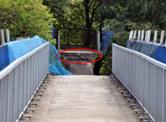

This pic is the best I've seen and given that the low loader is currently crushed under the weight of the bridge so probably 0.5m lower than it would have been and an eye witness report who heard a "loud bang", it looks like the digger arm hit the side of the bridge hard enough to hit it sideways off its support on the outside of the carriageway.
Now whether the bridge was as high as it should have been or the digger was over the maximum height is going to be the key question.

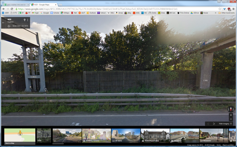

Here's the street view from Google Maps; I'd say the gantry is higher up than the walkway

That's a good view, but exaggerates it a bit as the edge of the hard shoulder is the key bit as the bridge is definitely on a slope down. The modern bridges and gantries are apparently 5.5-5.7m, but the bridges only need to be 5.03 (16 ft 6") though whether that applied to the hard shoulder when they built the motorway is not clear.
either way its quite a bit less than the gantry.
Interestingly the HSE website quotes 5.1m (!) and the new super tall trailers are up to 4.9m. Definitely scary seeing those go under some of the bridges.

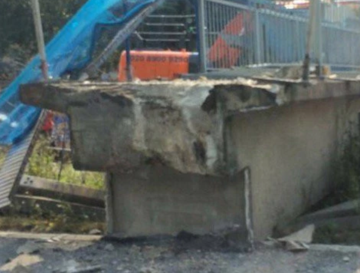

Anyway, looking at the pictures of the pedestrian bridge, is it my imagination or does it not have much (any?) visible rebar where the break is?

No its not your imagination. The design of this particular bridge is a bit odd and the section that feel off was basically a simply supported beam resting on two supports. The far side of the bridge is a much more solid cantilever....
Two separate pre-cast sections lifted into place, held there by gravity and the grace of God. And maybe a little engineering judgement that didn't foresee forty-odd tonnes hitting it at 56mph...
Apparently the lorry hitting it was crawling along the hard shoulder so 5.6 mph would be closer. ... Does seem remarkable that it was essentially gravity holding it all together for the last 25 yeasts.
Not too odd. "Cantilever" style bridge construction with a "suspended span". Fairly efficient, and very constructable.
Although I'm most used to seeing it for large steel trusses over waterways -- lower collision risk there!
Got it, it was the location of one of the 'simple supports' that was throwing me off.

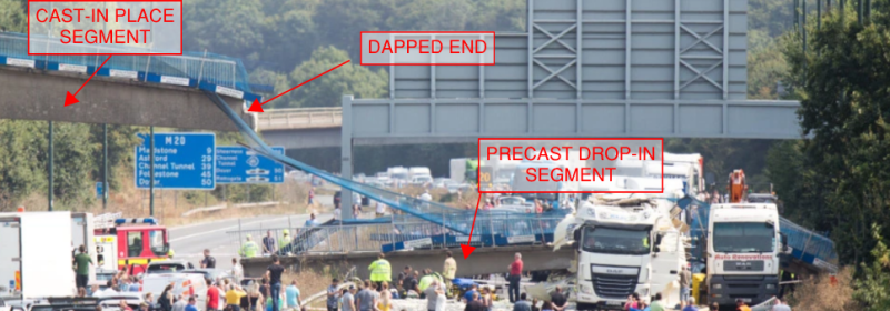

To me, though I'm far from an expert, the odd thing is that there is one long cantilever over about half the span / motorway, then this beam between the end of the cantilever and what is basically a pin support. If you look back at the google streetview images I posted on 30/8 at 0843, you can fairly clearly see the beam section ends. The first half cantilever stood the test and was suspended over the motorway until it was demolished a few day later.
The design is also strange as the bridge deck is clearly on a slope down from one side to another but also narrows down as it gets to the far side.
I think someone went a bit too far trying to save on concrete and the height of stairs on the far side. This is a pedestrian bridge which then has a circular walkway on the side it was hit.
If anyone had actually been on it when it was hit it's fairly clear they would have died. how no one else was seriously injured is a minor miracle which might not happen next time.

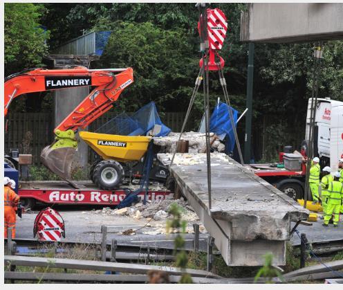

LittleInch, what you describe is pretty much the framing, using what appears to be cast-in-place section with dapped end (on the left), then the a precast drop-in (maybe should be retitled 'drop-down' :-0), with the far right end of the precast supported in a simple seat over the pier, as per below tagged photo:
The dapped end of the precast segment, in detail:
The far right support end over the pier:
This is somewhat common framing, using precast segments, and cast-in place too. Evidently, the lateral capacity of the simple seats is questionable.
