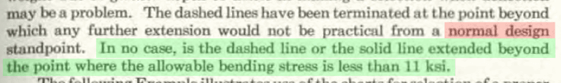

SRE, is your attachment for the typical case of LTB assessment, with restrained sections at supports and potentially also within the span? It says the unbraced length is usually less than the total span, and imposes a lower limit of 11ksi allowable stress (46% of allowable section capacity).

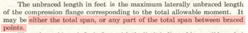

Steveh49 - The section that I attached yesterday addresses both charts used to select a beam and the equations that are used for unbraced lengths that exceed the values in the charts. The note about 11 ksi allowable stress is one of two cut-off limits where the charts stop. The other limit on the charts is unbraced length exceeding 25 feet.
The equations are for conditions that go beyond "normal design" when any of the following apply:
1) Unbraced length > 25'
2) Allowable stress is < 11 ksi
3) Beams not included in the charts.

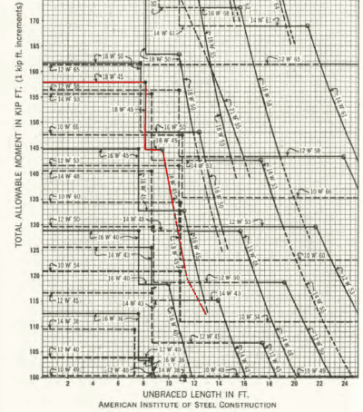

Here is an image of a chart, I've highlighted the line for a 18WF45. A more readable copy of this page is attached.
For either the charts or the equations the unbraced length can be all or part of the span:

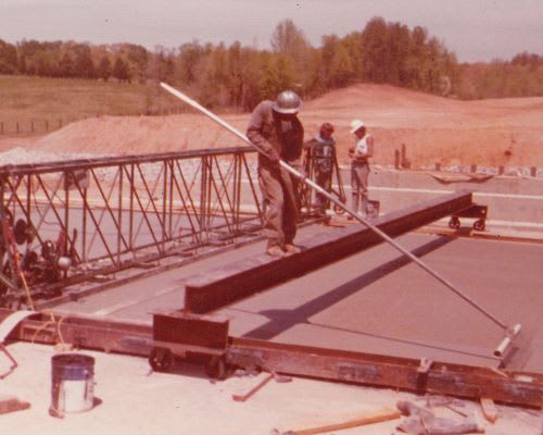

I don't see that the support restraints are addressed. The times I used the equations, the bottom flange was welded to moveable support. The top flange was not restrained in any way at any location. This is a photo of my first work bridge over a fresh concrete bridge slab. Although it does not look like it in the photo, the HP12x53 beam is 35' long.
The longest work bridge I design/constructed/used was identical to the photo but the beam was a 60' long, HP10x42.
Applied bending stress (beam self-weigh + 300 lb allowance for a worker at midspan) = 6.47 KSI
Allowable bending stress from Equation (5) = 7.22 KSI
I walked across it, stable, but somewhat like a trampoline with a little LTB "wobble" from side to side. Not a problem.

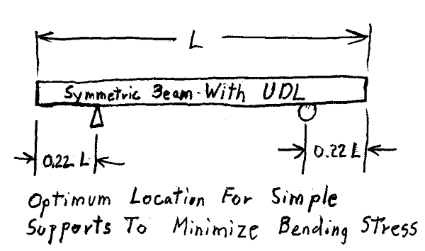

Steve - Bottom flange not welded... since the AISC manuals (6[sup]th[/sup] through 9[sup]th[/sup]) don't address the supports, yes, I would use the equations, but with self-imposed restrictions:
1) Only for on-site temporary storage of beams where the only load is the (static) self-weight of the beam.
2) Maximum beam length of 60', all unbraced (if the equations verify this is ok).
3) Brace beams that are "tall" and/or have "narrow" flanges to resist wind load.
4) Located supports (dunnage) to minimize beam's bending stress. Placing the supports as shown reduces bending stress to about 20% of it's value compared with supports at the ends of the beams. Since negative moment at supports approximately equals the positive moment at mid-span, the beam has to be symmetric.
