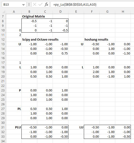

Using the Scipy.Linalg LU function via Excel:
If I set permute_I to false I get the same as hoshang:
Lower =
1 0 0
-0 1 0
0.5 0.5 1
Upper =
-1 -1 -1
0 -1 -0.5
0 0 0.75
If I set permute_I to true I get the same as greg:
Permuted Lower =
0.5 0.5 1
1 0 0
-0 1 0
Upper =
-1 -1 -1
0 -1 -0.5
0 0 0.75
So greg's results give the permuted lower matrix. I'd have to remind myself of how these things work to know what you do with that.

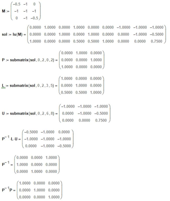

The results from Mathcad 14 are the same, and the extracted L, U, and P matrices behave as expected with P*M = L*U

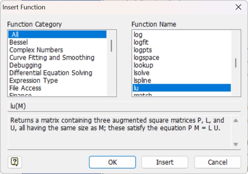

OK, so Mathcad's LU decomposition is a general purpose decomposition, see
The function assumes that a permutation matrix P is required to make the decomposition work; this is why the lu() function returns 3 matrices.

OK, so it seems the answer to the question:
I wonder why LU for this matrix retrieves such LU decomposition result.
is that there is more than one way to decompose a matrix.
It seems that Scipy and Octave are using a pivotted lower matrix, so that for an original matrix A:
PLU = A
whereas for hoshang's matrices:
LU = A
Excel screen shot, calling Scipy fumctions:
Apparently Mathcad is doing something different, but I don't have Mathcad to see what is going on there.

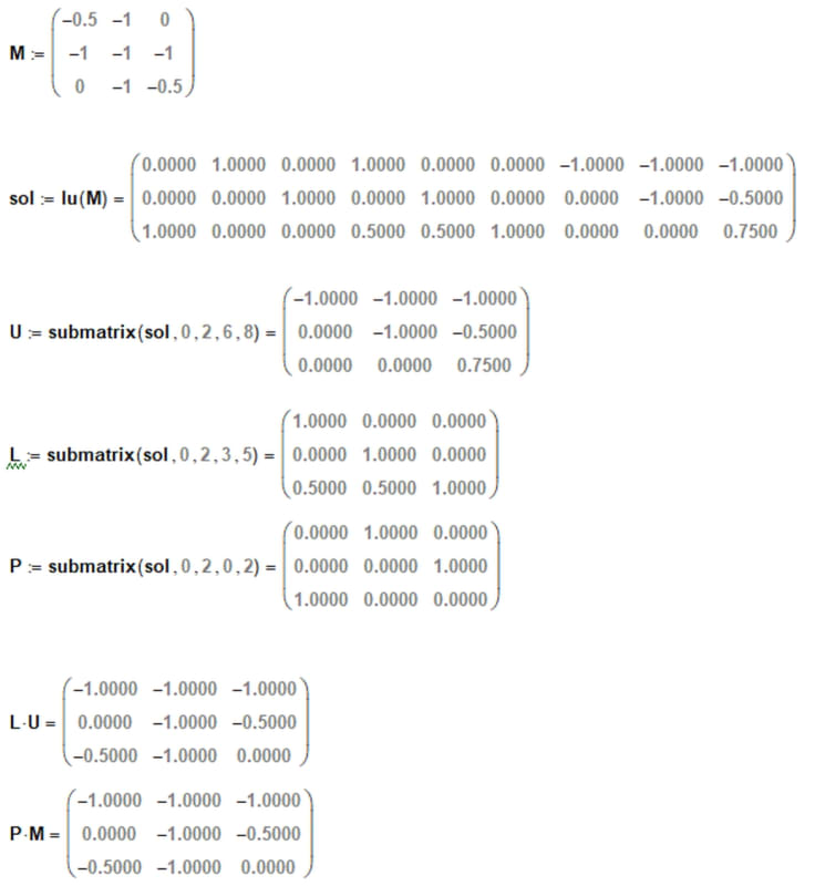

Mathcad is doing P*M = L*U, and the link I posted indicates that when LU decomposition is possible, there may be multiple solutions, and P in Mathcad's case is the inverse of the P in Doug's example, as can be seen below
