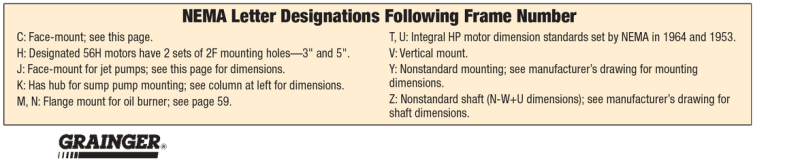

I am suspect of your statement that the motors appear to be custom, not saying you are mistaken, I've just never seen it, especially for the HPs you reference. I'd circle back around to BrianPetersen's suggestion to first see if it's possible to swap these out for single phase or like voltage 3 phase. You might even consider taking pictures of them and nameplates and going down to a local motor repair / rebuild shop to see if they can assist you, might even be willing to swap you out, and maybe with the help of an (as Johnny Cash would say) A-dapter kit. This could be much cheaper than purchasing and installing all of the equipment myself, you and others have mentioned.
A lot of machine tools have "special"motors.
A special motor is normally a standard frame size with the exception of the shaft extension.
Special shafts are not uncommon on face mount or flange mount motors.
Ohm's law
Not just a good idea;
It's the LAW!
Thank you for your suggestion, we actually are the local motor repair shop, and we might be able to rewind the motors to get them into 240V 3-Ph, but we couldn't reconfigure them to be single phase, and two rewind jobs would be more expensive than the drive + transformer route. Plus I would still have to set him up with a phase converter/VFD after the fact. One of these motors is Italian, I think the other is custom Chinese, but neither of them have a standard frame size listed which would make finding subs a real bother. I'll attach the nameplates just for kicks.
