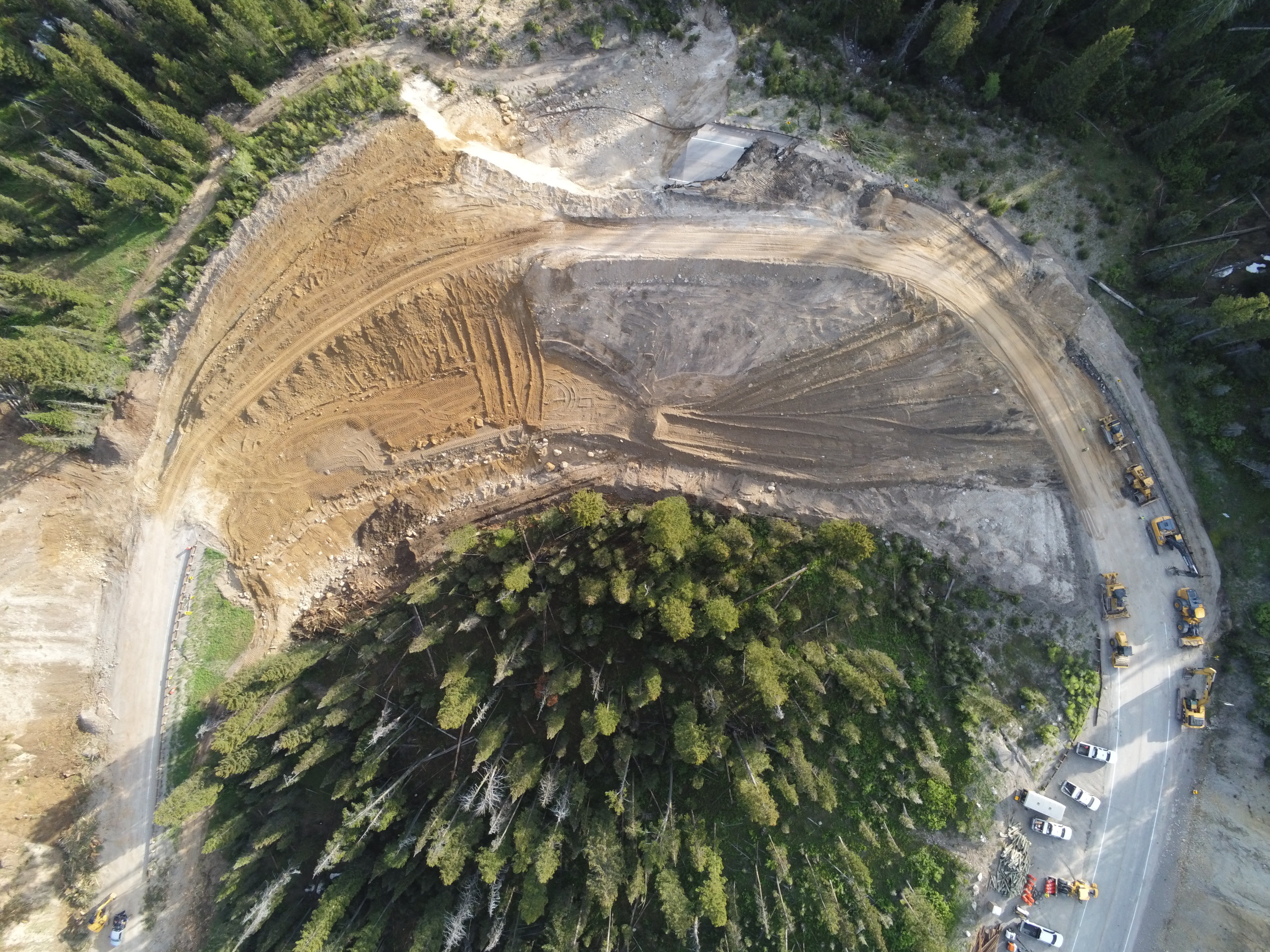

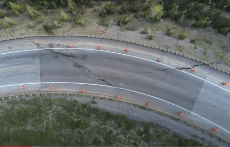

Looks like some pretty steep and tall slopes on that cut and fill work.
Given the other mud flows in the area, there must have been a lot of rain and snow melt saturating the ground.
Yea, that's going to take awhile to repair ;-)

I'm no expert on geotechnical engineering. But I am astounded that the Wyoming Department of transport thought they could reopen this road in a few days and that they already had works begun.
On a slope as steep as this it doesn't take a genius to see that this is a big problem.

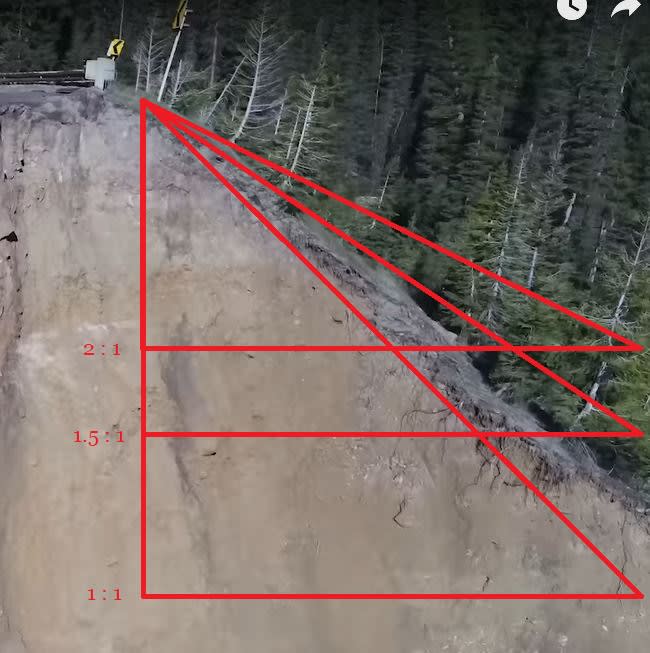

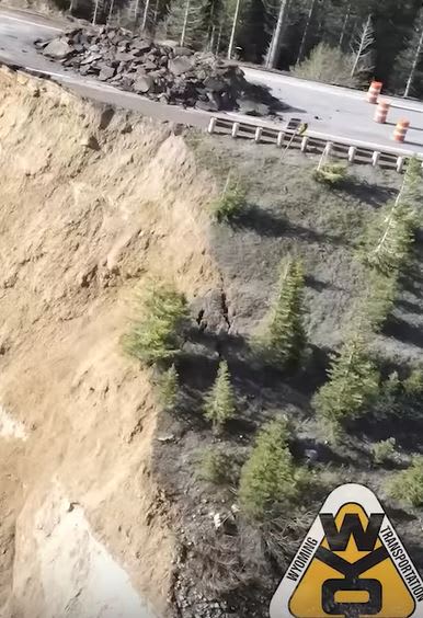

In the video assessment by Casey he said it looked like slopes were in the range of 2:1. It's hard to gauge from the drone footage, but to my eye they look a lot steeper than that. They do seem to vary as well as you move along the curve. [Edit: In Casey's second video he acknowledged that slopes appear greater than 2:1.]
Also, any fix seems to be constrained downhill by a creek as to the minimum slope they can lay without additional measures. Hard to see them proceeding successfully without some kind of geogrid or downhill retaining structure. Here's a link to short PDF put out by the Forest Service on slope stabilization. Link
From the image you posted, the slope of the fill appears to be inconsistent (My apologies, I repeated what you stated. In that case, I agree with you). This could be due to poor construction or years of settlement. Either way, it would only be by luck if the design parameters were being met at the steepest inclination. This road has served for many years (I believe I drove it in 1980) so I would consider this issue as a maintenance concern. Perhaps, as with much infrastructure and technology, upgrades are required.

https://www.jhnewsandguide.com/news/environmental/budge-slide-expert-urges-careful-engineering-on-teton-pass-rebuild/article_dc05020a-281c-11ef-9c12-6fa7fde7b3b7.html[/URL]]Hammond said WYDOT is already contemplating some sort of “stabilization effort” in the native material underneath the “Big Fill.” It’s not yet clear what that will look like.
[ponder] This seems backwards.

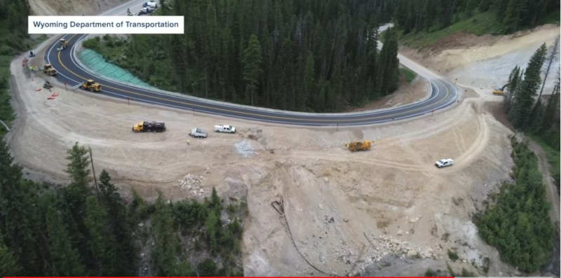

Backwards, or maybe upside down. They are likely investigating injecting something into the material in question.
It may be a belt and suspenders approach. Rebuild the road safely, then install some ground improvement elements or compaction grouting. It’s difficult to do the ground improvement first when you have a tall scarp hanging over your head.

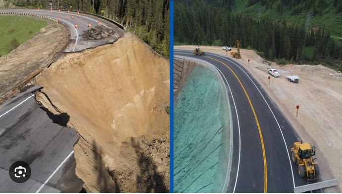

Creepy. Just throw some dirt over the side. They'll believe us if we say it was the weather.
I hope they have some good speed reduction signage since that downhill curve is now much tighter.
They did put hydroseed down so they did something...
Does the hydroseed just hide the first signs of the next failure?
