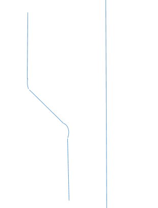

Where else have you seen parts made that look like this:
This is to scale proportion, to save others from spending 10 or 20 minutes seeing exactly what is required, based on the description so far.

Thanks to 3DDave, I now understand the geometry. No similarity to a bicycle fork.

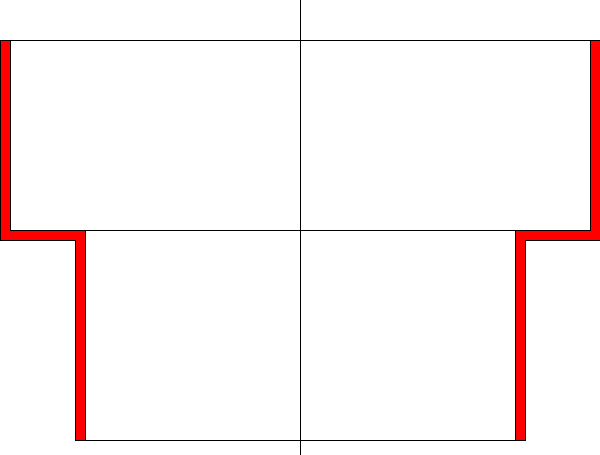

3DDave has chosen the most horrible interpretation of the OP's desired geometry, probably deliberately. Here's one that my expert draftie knocked up that could be made much more reliably in any quantity.

I would find a tube of the same OD and of the same smaller ID of the shape shown by 3DDave and machine the inside to the same large diameter shown in the same drawing. to the desired depth.
