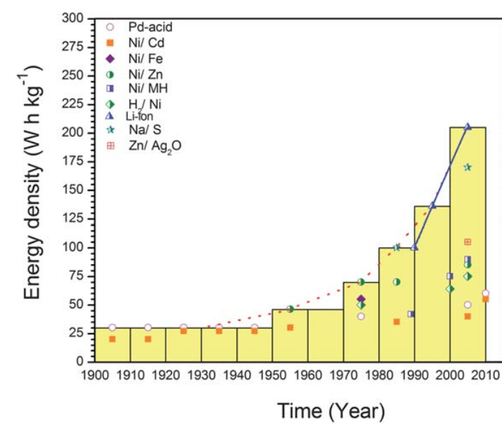

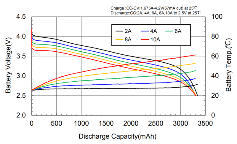

If you want to feel secure in spending your time developing this engine, you could perhaps project forward from the past trends in battery improvements. Perhaps ask a chemical engineer what the max possible energy per kg per battery is. It has been a while since I've taken chemistry, but I remember in some battery chemistries we currently have a lot of headroom for improvement in theoretical available power. Some of that has to do with how fast power is demanded, as lower amp draws can produce more total power output from the battery, temperature, etc.
I think it's impractical to think of something needing high power as being capable to extract a lot of the theoretically available power from today's batteries.
The pack could be oversized to be able to produce any desired amp draw for as long as they'd like, however, then you have added weight.

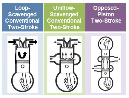

One thing I considered for a while, was two strokes. Something like this:
applying the atkinson cycle:
could expand a given air fuel volume for a long time. With valves you could do variable valve timing whenever you wanted, and get full power whenever you wanted.
you already have a source of forced induction, this piston & crank case volume. You could more easily vary the volume of the crankcase with a plunger to vary the amount of air forced into the combustion chamber and to reduce pumping losses. You could do port or direct injection. you could do it mazda skyactiv style for efficient combustion.
It feels like growth in battery energy density is slowing, presumably because of the physics. There's a *lot* of money being thrown at improvement, so we should see better phone/laptop/auto batteries soon if physics can be overcome. It's also possible the physics mean the dream battery will be like fusion, just around the corner for decades to come. Only time will tell.
My engine is an opposed-piston two-stroke, and it uses the Atkinson cycle (or the Miller cycle depending on intake pressure). What makes it unique is the fact that it's a rotating-cylinder radial using HCCI. Because the engine block is a rotor, centrifugal force can be used to pump coolant, fuel, and air through the block. Permanent magnets can also be mounted on the rotor with coils in the rotor housing to effect a motor/generator for starting, reverse, and hybrid operations. All this is in my patent application (which *finally* made it to the top of an examiner's in-box last week).
A traditional crankcase induction pump is inefficient in normal use because it creates pressure that's unused and has significant transfer port volume. Moving air in an isobaric system requires work in proportion to volume and pressure (W = Pressure * DeltaVolume) with pressure determined by time (RPM and port area) and DeltaVolume defined by pump volume (the only changing volume). Minimizing pumping loss boils down to minimizing pressure (increasing port area) and eliminating unnecessary volume (pump clearance and transfer channel volume). Note if the pump and transfer channels are pressurized before the transfer and exhaust ports are open, then it's an isentropic system with work defined as AirMass * Cv * DeltaTemperature which yields much larger numbers than the isobaric calculations. Whether isobaric or isentropic, the pressure built up in the induction system is not expanded, the work required to compress the intake charge is lost, so it's best to minimize pressure and the dead volume in the pump and transfer channels. This is why multi-cylinder two-strokes are often arranged such that the pump under one piston charges another piston whose transfer and exhaust ports are opening just as the pumping piston begins its downward stroke.
