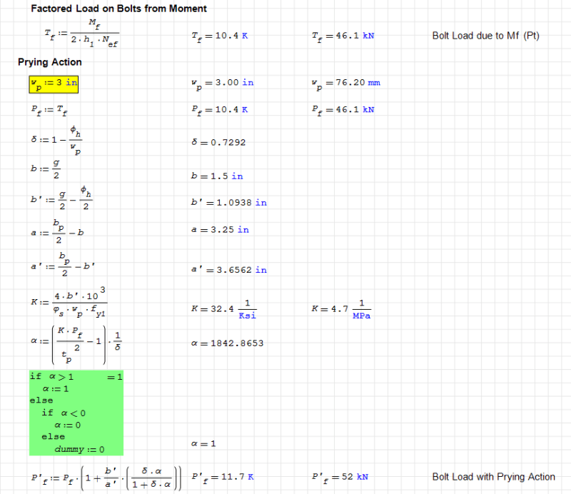

Is there a maximum bolt spacing?
Logically, it seems there should be a maximum vertical distance between the two bottom bolts to minimize prying action to the bolts from any plate bending, or at least a maximum/minimum plate thickness to bolt distance ratio of sorts.
Mike McCann, PE, SE (WA, HI)
Prying action is already considered...

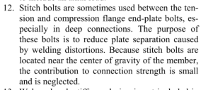

It looks like AISC Design Guide 16 on Extended End Plate Moment Connections uses a distance between bolts of greater than 12" for the examples used. They didn't consider or mention adding bolts. The only thing they mention about bolt spacing is the following snippet from page 13 (Additional assumptions):
The PEMB business regularly exceeds the 12" maximum distance. I've thought the maximum bolt spacing is for bolts that are considered to act together. Since your tension bolts take all the tension load, and your compression zone bolts take the shear (i.e. you're not mixing shear resistance between bolts at the top and bottom of the connection), I would think the max spacing wouldn't apply for this connection type.

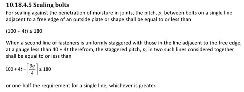

dik, the only Canadian guidance on maximum bolt pitch, that I know of, is in S6. See clipping below of relevant clause. Again, this has to do with sealing the two plates, which doesn't seem to be a concern in your case.
that's what I'm basing it on... rather than bolted end plate, they want to do field weld CJP welds... and were taken back a bit when I told them all welds would have to be x-rayed...
Thanks Canpro... actually have a copy of that somewhere... will dust it off...
