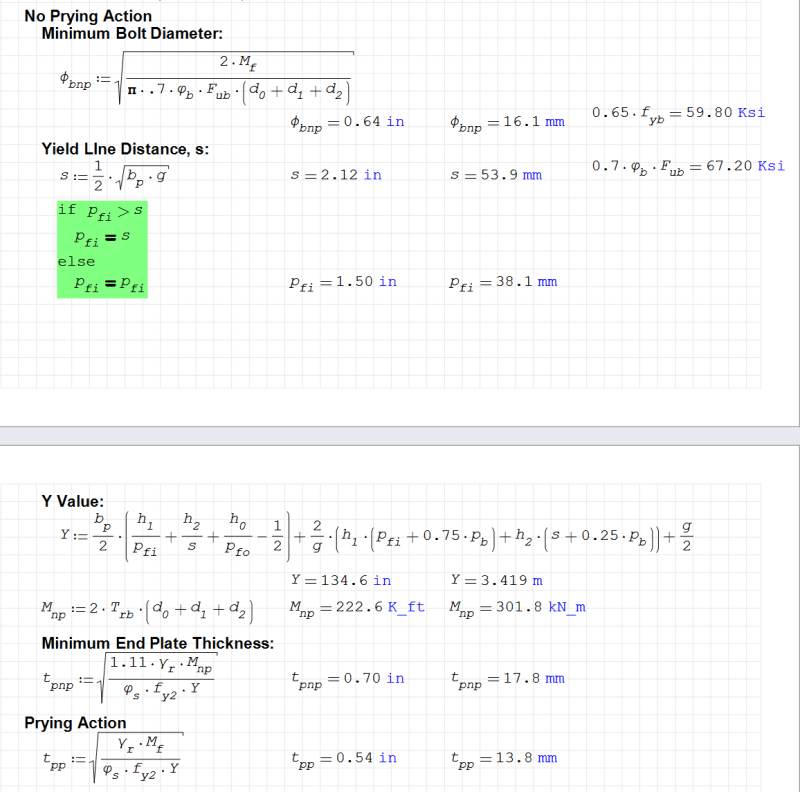

For one, you need to layout the bolts plate to be compatible with the yield lines from the AISC design guide equations. I am sure AISC can answer the question directly as well. thanks
You set the bolt locations for the yield lines, with the exception of dimension s, which AISC caliculates... the design is compatible with the AISC approach.
