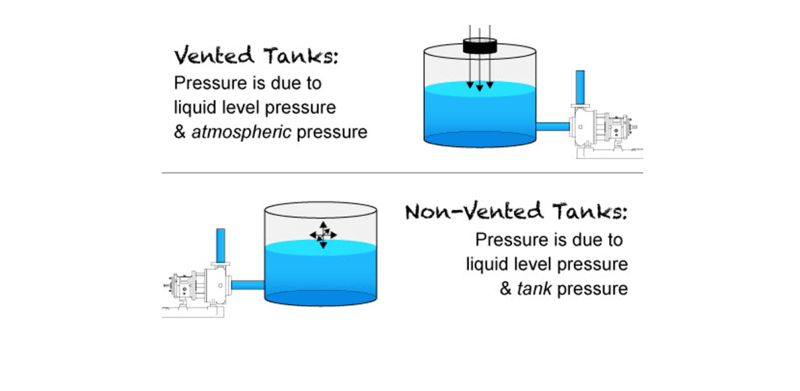

I'll make fun of both you and friend. You correct for NPSHa by adding atmospheric pressure.
NPSHR is given in "absolute ft" or when converted to pressure, it is absolute pressure.
"(so 25' is really 25-14.7= 10.3', 4.5psi, if monitored by gauge"
You cannot subtract psi from feet. Convert the psi to feet and then you can.
If it is psi, rather than 25', you add 25psi to 14.7 psi =40psi, that's 92.3 feet of water.
NPSHA is calculated by summing the following
+Ft of Head equivalent of applied pressure, if drawing from a pressurized tank or pipeline)
+Ft of elevation (+ is elevation of suction water surface above centerline of pump)
..... If drawing from a pressurized pipeline, use pipe centerline elevation,
..... by converting gage pressure from gage elevation to pipe centerline, or
..... simply use the elevation of the gage.
-Ft of Friction loss in suction pipe, valves, fittings and tank exit coefficients
-Ft Head equivalent of vapor pressure
+Velocity head (often ignored)

Atmospheric pressure is added to the NPSHa when you have an open tank, but is not added to the pressure from a pressurized pipeline.
Per your stated pressures, you don't have adequate NPSHa to make this system work. With a flow of 300 gpm, you have 17.5 psi pipeline headloss. That would leave you with 0 - 2.5 psi NPSHa.
As others have stated, you need a bigger pipe diameter or relocation of the pump.
bimr: my experience is NO direct pumping from the main as it can lead to putting the main under vacuum (vacuum breakers can fail).
The quick cals. I did, probably 200GPM is not achievable.
Gravity storage tank at the discharge seems the best solution and could even negate the need for a pump - not unlike refilling the water tanks in the railway steams engines of years ago.
There is no difference between the calculation for a closed pressurized tank, or a closed pressurized pipeline.
NPSHa calculation is the same for all. The same for an open or a closed tank, or a pressurized pipeline. The object being to obtain total head, which always includes atmospheric pressure. As gage pressures do not ever include Patm, whenever you have a gage pressure, be it from a gage placed on a pipeline, or on a tank, it needs to be added.
This link has several examples of the NPSHA calculation, showing both that for open and closed tanks. Note that the pressure given for the closed tank example is already in units of PSIA, so Patm has already been added to the tank's gage pressure reading.
There is no difference at all between the calculation for any open, or closed pressurized tank, or a closed pressurized pipeline.
What follows however is somewhat different between tanks and pipelines.
Including Velocity Head
If you include velocity head, rather than ignore it, you must use the velocity at the point where the pressure reading is taken. If the gage is on a tank, the velocity in the tank is probably zero, or very close to zero, as a tank's area of flow is usually very large and velocities within very, very small. If the gage is on a pipeline, the velocity will probably be small, but not zero and, if there is a velocity, the pressure gage will not include any velocity head in its reading of static pressure head alone, therefore you can add the velocity head at that point where the gage is attached, if you want to account for velocities heads. It is conservative to ignore it and they usually don't amount to much anyway.
Note: Following reference specifically says Psuction = "stagnation pressure"
Stagnation pressure includes any velocity head
There is no difference at all between the calculation for any open, or closed pressurized tank, or a closed pressurized pipeline.even when including Velocity head, but you must remember to use the velocity at the pressure gage's location, whenever you choose to include velocity head.

Atmospheric pressure is not added unless the tank is open to the atmosphere:
In the OP post, the system is not open to the atmosphere.
