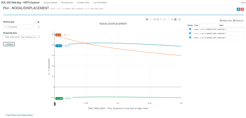

The displacement output is the displacement of physical coordinates, not modal coordinates. The initial conditions were defined on the modal coordinates, so I don't expect the displacement in physical coordinates to match.
Per your inquiry, I think you want the initial conditions applied to the physical coordinates of the grid.
This is how you do it. The BDF used and the confirmation are further down.
[ol 1]
[li]Use IC=20[/li]
[li]Apply the initial conditions to DOF 1[/li]
[li]Apply the initial conditions to grids 2, 3, 4. If you apply the IC to grid 1, you get an error because grid 1 is fixed.[/li]
[/ol]
Here is my displacement and velocity output and you can see I get the initial conditions defined in the BDF file.

Here is a plot of the time history for grids 2, 3 and 4. Again, the same initial conditions occur at t=0.
