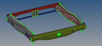

The following picture shows the first non-zero mode#7 animated vibrating at 4.6 Hz
