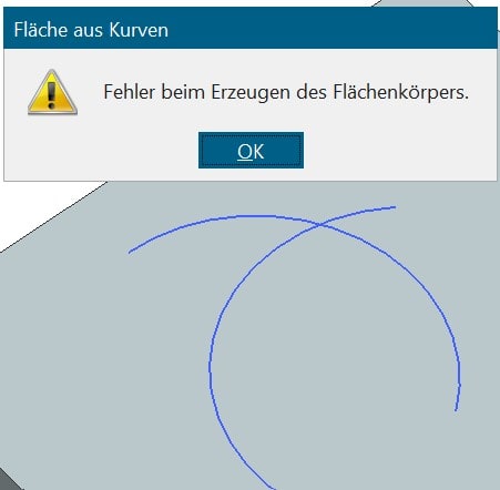

Hello all,
I tried to measure the area of a closed composite curve, which is composed of 3 curves in Siemens NX.
However the system told me error, when I tried each time...
Does anyone know how to solve the problem?
Or is there a better way to measure the area of a closed composite curve in Siemens NX?
(I couldn't find proper resources in Google...)
Thanks for a reply in advance!
Best regards,
Ray
I suspect the curves do not intersect.
Thanks for your reply!
The three curves don't intersect; otherwise I couldn't have made them composite.
I tried a intersect version, but still in vain...
Should the curves be intersect for the function "area from curves"?
Best regards,
Ray
what I meant was the curves don't close (to create an area within them).
Possibly one curve is a composite of other curves, and maybe this is a problem. Then divide your area into pieces so that each side is a single curve.
Perhaps they aren't co-planar.
