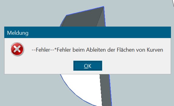

Hello all,
I tried to measure the area of a closed composite curve, which is composed of 3 curves in Siemens NX.
However the system told me error, when I tried each time...
Does anyone know how to solve the problem?
Or is there a better way to measure the area of a closed composite curve in Siemens NX?
(I couldn't find proper resources in Google...)
Thanks for a reply in advance!
Best regards,
Ray
I suspect the curves do not intersect.
Thanks for your reply!
The three curves don't intersect; otherwise I couldn't have made them composite.
I tried a intersect version, but still in vain...
Should the curves be intersect for the function "area from curves"?
Best regards,
Ray
what I meant was the curves don't close (to create an area within them).
Possibly one curve is a composite of other curves, and maybe this is a problem. Then divide your area into pieces so that each side is a single curve.

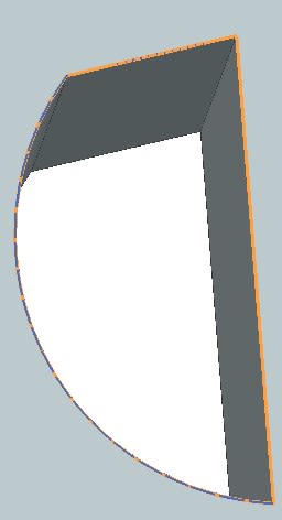

Hello all,
Thanks for the hint. After removing the composite feature, I could finally create a face with the three individual curves.
The problem now is, the recorded journal doesn't record its area from measure.
If I want to get the green area, is there a better way than the method above?
Another solution I came up with is extruding->measure area ->delete extrusion, which is obviously not better...
Best regards,
Ray
don't really understand "recorded journal" ? You're using Siemens NX, so something like FeMap. In FeMap under Tools there is Measure which includes Surface Area. If you've created a bounded surface there there are several ways to measure it, Properties and the like.
