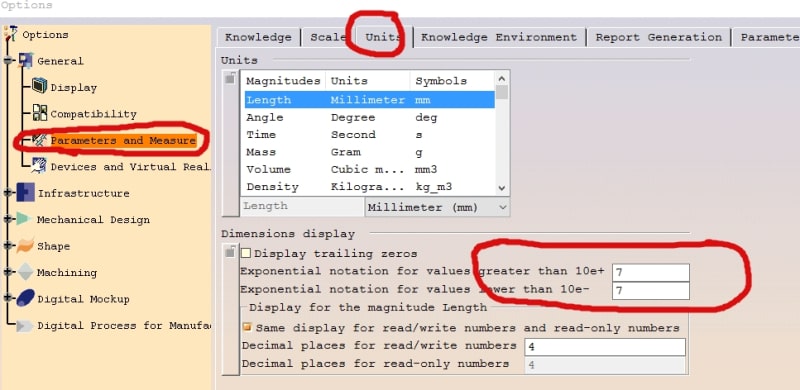

How could I get a real value of the measurement (no equation!!!!)?
CAD 2015
Change your exponential notation to a higher number.
