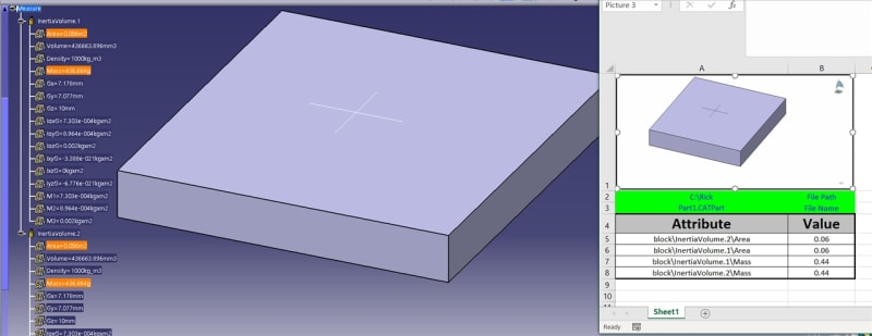

Here is a catscript that will get you close, probably a few tweaks to get exactly what you want.
This requires pre-selecting what you want to be exported to excel.
Script will export a screen shot, file name, file path & the pre-selected attributes.
The attributes will be listed in the order that they were selected.
