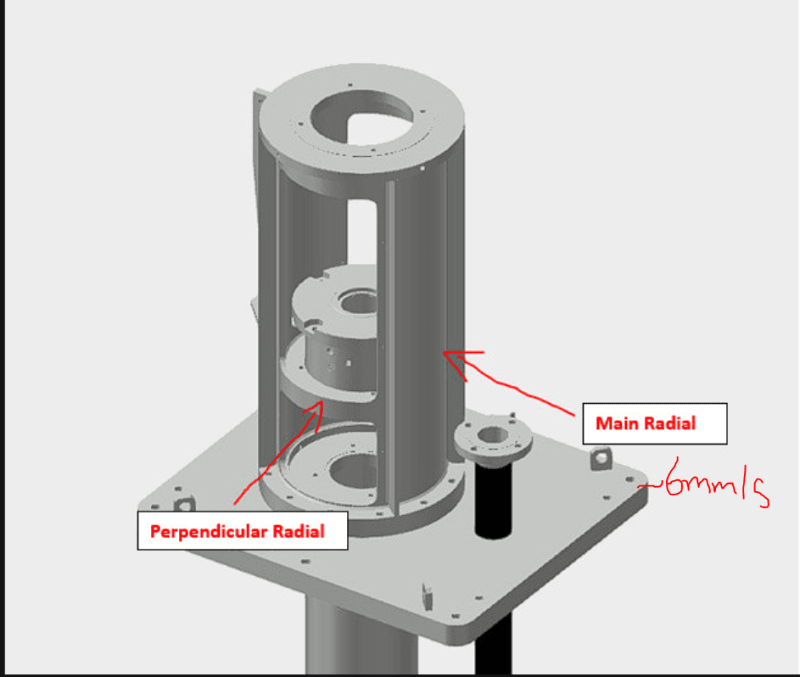

Looking for some advice. On the plant where I work, we have an API 610 VS4 pump. The pump is having high vibration only in one radial direction (almost 6mm/s - too high for a newly commissionned mechine), while axial and other radial vibration are within ISO limits.

The callout for M20 "leveling screws" in the drawing suggests to me the base plate may be "supported" at just a few points, even if after leveling it was grouted with good workmanship.
Sometimes millwrights install "leveling nuts" on the anchor bolts under the base plate. That technique is good for leveling signs and light posts in a parking lot, but will leave a rotating machinery base free to shimmy no matter how hard the anchors are tightened.
Then the there are the angle support beams/joists shown in the drawing.
That support structure is guilty until PROVEN innocent.

Factor of 8.5 difference in 1x component (6mm/sec and 0.7mm/sec) in the 2 radial directions on a vertical machine, it's a slam dunk resonance imo.
We can also see that the tall cutouts in the stool supporting the motor would create an enormous difference in stiffness in the 2 radial directions.
As Tmoose suggested, bump test is a typical step for checking resonance. Bump in both directions for comparison and I'm sure you'll see a big difference in natural frequencies. Bump test while secured on a vertical machine might be a little off due to mass of the fluid but should be close to accurate.
I have to pause for a moment to think about which direction is stiffer and accordingly which direction we expect to be higher in frequency.

[li]First gut reaction is the 6 mm/sec direction is stiffer since that's where all the metal is. [/li]
[li]But second thought is that it resembles 2 plates, and those plates are stiffer when bending in the 0.7mm/sec direction than when bending in the 6 mm/sec direction.[/li]
[/ul]
I lean towards the second-thought conclusion (stiffer in the 0.7 mm/sec direction based on the way the two plates bend), but either way if you see a big difference in resonant frequencies and natural frequency near running speed in the 6mm/s direction then that's your confirmation.

Attached is an image based on the OP's pump "drawing" .
4 leveling bolts in the corners, but no indication of grout etc to create full support for the base plate. If so, and there are gaps between the base plate and the tank top, and the six anchor bolts will try to close gap at least locally around each anchor.
So the pump assembly resembles a hair brush sitting bristles down on a table.
It appears the 60 mm thick base plate is mounted directly to a tank opening.
The tank opening may be stiffened by 200 X 200 x 50 mm angle ? 8" X 8" X 2" ?
May be a frame around the opening. Maybe some of the angles extend (TBD) to decent vertical supports.
Or not.
