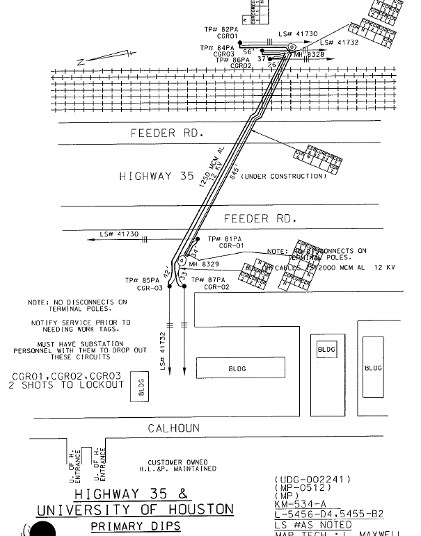

I work at a large University in Texas. When the electrical deregulation happened here the utility built us our own 138kv/12,470kv substation. Ever since we have had issues with our concentric neutrals burning up on our pole tops and splices burn up in our manholes every few years.

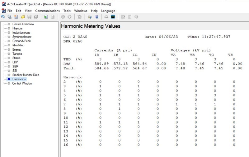

Although my SEL relays only show about 25amps of neutral current, I have measured 200 amps on the pole top jumpers between the concentric neutrals on the cable to the main neutral cable. See attached pictures for examples of the very strange readings.
I recently walked the line and noticed there are still some interconnections between our circuit's neutrals and the utility company (Center Point) city circuits that all originally came from the utility substation that these circuits used to originate in. Could this cause circulating neutral current at these levels?
The SEL relay also does not show excessive harmonics.

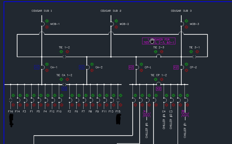

These are our main feeders from our substation Delta/Wye 138/12 KV transformer to our main gear on campus which connects to a ring bus. Entire run is about 1.1 miles from Sub to Central Plant. Some underground, some overhead.
We have 3 circuits, 2 of which feed a Main tie Main gear. 1 of which normally only feeds our Central Plant. The 2 that go to the main tie main gear each break out into 8 sub feeders which power our campus buildings. The Sub feeder cables do not have concentric neutrals tape shield only.
I should also mention that our incoming Main Feeders have a Nexus 1500+ power quality meter and although they do not have neutral CT's installed the meters do not show any calculated neutral current. But if I put an amp probe on the concentric neutrals at the back of the gear i can read up to 200 amps.
Anyone ever see this before? Any ideas?

There is a lot of information in your posts and it would be really helpful if you could possibly insert the details onto a schematic which includes the neutral grounding locations and any ring arrangements. It might provide a better presentation to allow the problem to be assessed more thoroughly.
I will see what I can find or create as it is difficult to describe. When you say Ring arrangements, are you talking about downstream ring bus?

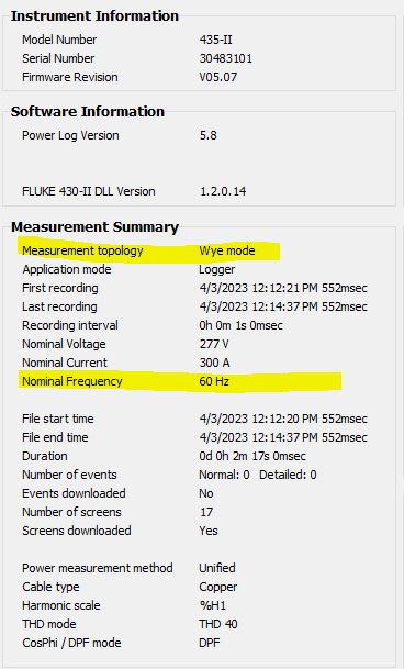

I’m not sure your PQ meter is set up right. I noticed that the frequency is set to 50 HZ, but if you’re in Texas that’s incorrect. Having the fundamental frequency set wrong would pretty much invalidate all the phaser and harmonic results.

When I first connected the meter, I had it set for Delta. When I corrected that I also checked the HZ. I don't understand why it shows as 50HZ on the screen shot.
Ok, weird. It’s been a bit since I set up a 435.

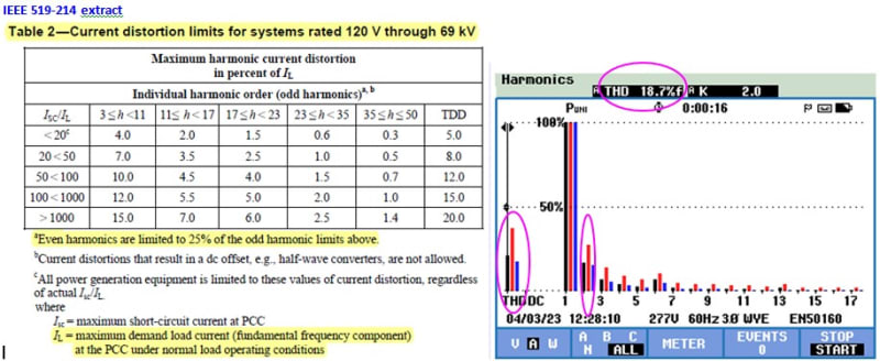

Your harmonics graph shows THDi of 18.7%. I believe IEEE Std 519 is your relevant harmonics standard and the attached Table 2 provides Total Demand Distortion (TDD or THDi at 100% load) limits of up to 20% if the fault level is extremely high (Isc/Il > 1000). Lower limits on weaker networks. Neither the fault level or the maximum demand is stated above, but the 18.7% THDi seems quite high compared to the standard. If the utility has set harmonic limits as part of your installation's grid Connection Agreement, it might be worth checking these to see whether they are being exceeded indicating a harmonic issue.
Secondly, the even harmonics in your table appear very high. Table 2 of IEEE 519 limits even harmonics to only 25% of the odd harmonics. Even for an extremely high fault level, the 2nd harmonic current should be less than 3.75% (0.25*15%). Depending on your fault level, it could be lower. The graph above indicates a 2nd harmonic current of between about 15 and 25% of fundamental depending on the phase.

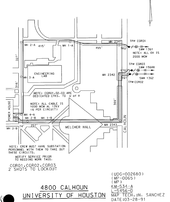

RonUH said:
the problem is that there is a 1/2 mile run of overhead where the CenterPoint city circuit does not have its own overhead neutral
Are you saying the blue overhead line doesn't have a neutral but the pink and teal do?
Is the tie breaker operated closed or open?
The colored lines indicate overhead neutrals. It is difficult to describe, the circled numbers are our circuits (CGR1,CGR2,CGR3). The ones marked CP are CenterPoint city circuits. Originally all these circuits were fed from the same CenterPoint substation. 2 of our circuits have an overhead neutral connected to the respective Concentrics. CGR2-Pink and CGR3-Teal. The Blue is a CenterPoint city circuit neutral that also connects to our CGR1 in their sub at one end but the other end of CGR1 at the rail yard is connected to the CGR3 overhead neutral and also connected to a different CenterPoint city circuit.
All ties are Normally open. At the moment we are using a tie (CA1-2 in the pics below) in our central plant since CGR1 is still out of service.

I absolutely agree with this point, the problem is that there is a 1/2 mile run of overhead where the CenterPoint city circuit does not have its own overhead neutral.
Is there a section of CenterPoint line with no neutral? If there is and there are connections on each side to the university system neutral, then the university neutral could be carrying unbalanced CenterPoint neutral current. Either get CenterPoint to install a neutral or disconnect all of your neutrals from their system. Disconnecting your neutrals may leave the CenterPoint system with no metallic path for unbalance current (load or fault) and may cause voltage problems on their system. Disconnecting your neutrals could be hazardous if the CenterPoint circuits are energized and carrying load.

My SEL relay doesn't show the same harmonics as the fluke meter. Could the harmonics I measured with the Fluke meter be picking up the harmonics from either the CenterPoint city circuit or possibly the induced circulating current?
I believe the Fluke 435 really wants voltage reference when making harmonic measurements (even harmonic current). You might be getting some odd readings if you didn't have the voltage connected. You also noted that the harmonics were "pulsing" as well when you were taking the readings. Additionally, a high 2nd harmonic is fairly odd so I don't think the fluke measurements are accurate.
I think you'd be having a lot more other issues if the current THD was truly at 18%. But I could be wrong as I usually am.

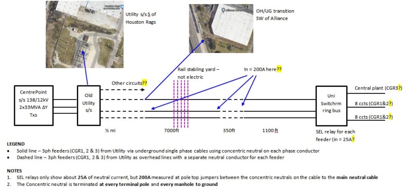

RonUH,
Thanks for the additional drawings. I’ve taken the liberty of putting together a sketch which may or may not properly collate your information. Please feel free to tag it as incorrect or otherwise correct any mistakes as appropriate if you think they will assist discussion. Other queries that I have, which may be relevant are
1. Where on the sketch have the 200A neutral currents been measured?
2. Where on the sketch have the neutrals been burning? (Closer to uni might point to uni sourced currents whilst closer to CentrePoint s/s might point to currents from other sources)
3. Have the neutral failures been associated with faults; either utility logged or university logged?
Given JJRoys comments about the Fluke’s inability to measure harmonics without a voltage source I’m inclined to think that other sources of neutral current returning to the utility substation could be worth considering. I'm not a protection expert, but the attached link to a short summary of cable screening shows a "cross-bonded cable system" that might apply to your installation. It gives various reasons why the technique compromises between circulating currents and induced voltages in the screen.
