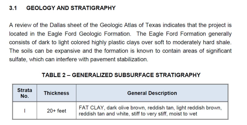

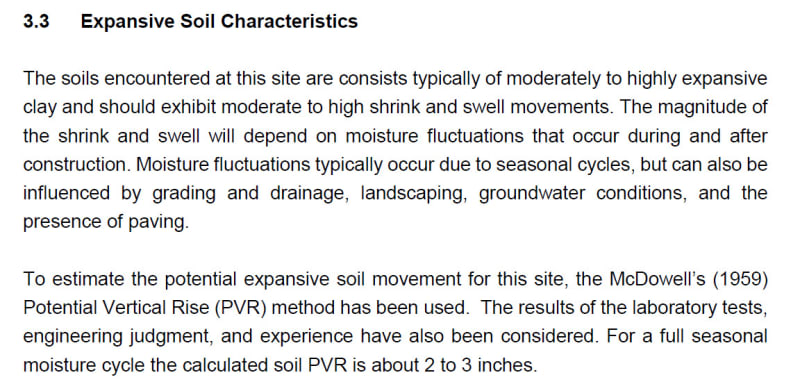

I have been watching this thread for several days, awaiting for definite information on the expansive soils:
What is the actual soil profile? How Expansive are the soils? What underlies the leveling sand?
I can picture some scenarios that the detail in question could work.
I know of many situations where the detail in question would be poor or even a disaster.
There is not enough information to provide the answer to the OP.
