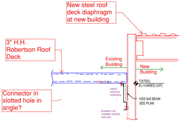

Hello,
I have a really difficult connection to detail here, and I am about out of ideas. I am trying to resupport existing steel roof deck (H.H. Robertson Type DC) on a brand new collector beam at the interface of an existing building and new building expansion. I want the connection to be able to transfer in-plane shear loads, but not take any transverse shear loads that could potentially cross the interface via the new roof diaphragm at the new building. Does anybody have any ideas as to how this can be achieved? I was thinking about using 1/4" A307 bolts in slotted holes in the angle, but I have never seen bolts be used to connect light gauge deck to structural steel.
I wouldn't try to make the slot at the angle to deck connection, I would rather make the thing that supports the angle to deck connection slotted. Basically try to move it downstream.
If you put a chord angle (heel pointing up) at the end of the EXISTING roof deck, would this not allow you to split the roof decks? You wouldn't have transverse shear trying to push into the higher diaphragm.

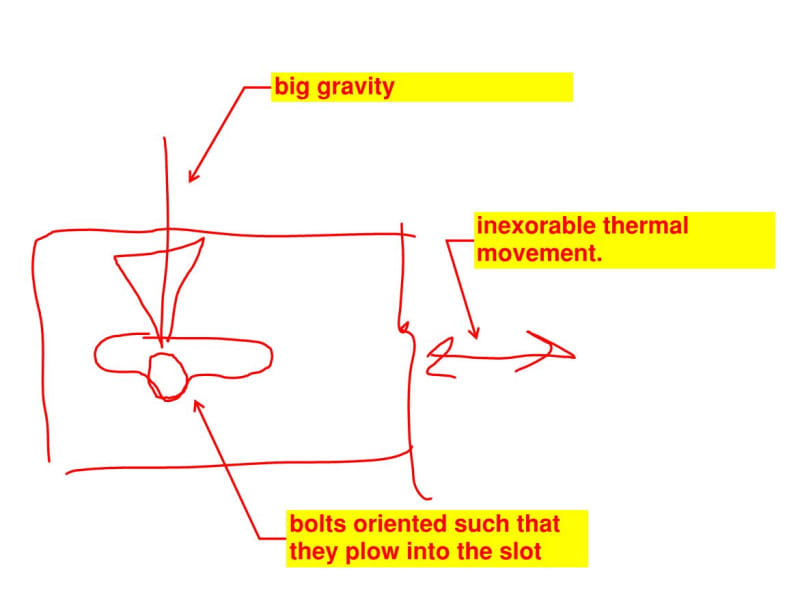

1) I'm of the opinion that any movement joint that relies on nothing more than slotted holes is junk that is likely to bind up for any number of reasons. This, even more so with cold formed steel than with hot rolled.
2) I suspect that any version of the detail that would do what you want reliably will wind up requiring teflon strips and all that jazz which would be prohibitively expensive.

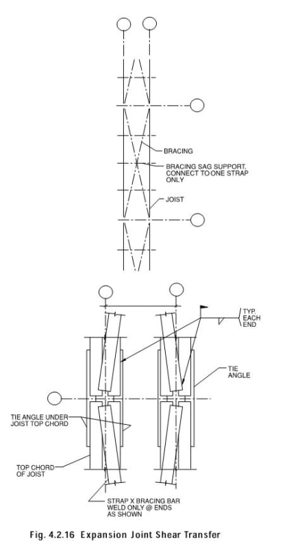

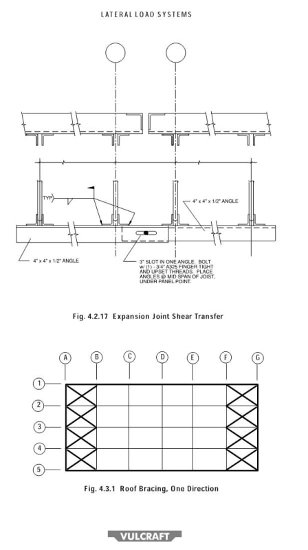

The nearest thing that comes to mind is this detail that's used in industrial buildings sometimes. It's not meant to transfer diaphragm shear in either direction. The angle with the slotted hole is just meant to iron out differential vertical deflection across the joint. In this instance, the slotted hole at least benefits from:
1) The slots are often in a dry, well ventilated, observable space and;
2) Thermal contraction forces can be monstrous so it's conceivable that those forces might overcome any binding in the slotted holes.

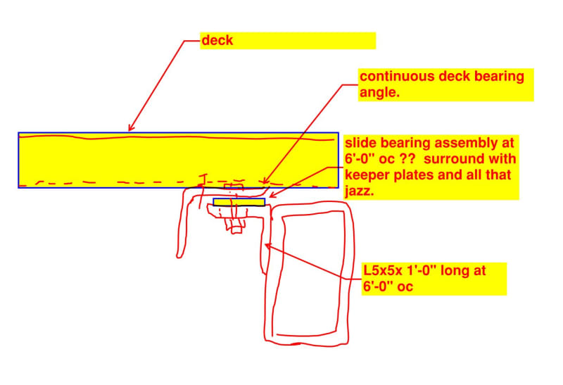

@ChiEngr: this is the closest thing that I can think of to fit within your limitations. It won't win you any popularity contests I don't think.
Kootk,
We are leaning towards doing something similar to what you suggested. I am working on the detail and will upload it here if you are curious. Definitely not winning a popularity contest.
I'm definitely curious. It's gracious (and brave) of you to consider sharing.
