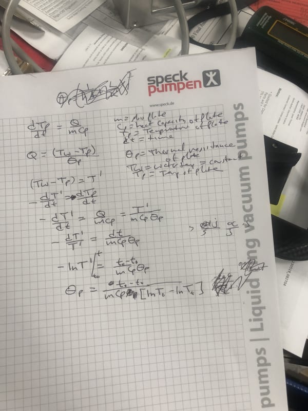

Steady state = simple.
Transient = difficult.
Transient drags in heat capacity.
Hello all,
How do we feel about the calculations on the image below to calculate Thermal resistance during transient states? Please let me know if anything looks off. I'd be tracking fluid temp, plate temp, and time.
