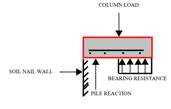

We questioned their pile loads as they seemed to be low for the column loads provided by the structural. The underpinning/shoring designer responded that the pile would only pick up half of the column load, assuming the other half of the footing would resist the column load via bearing pressure. They included the bearing pressure as a surcharge load in the soil nail wall analysis, but there is a strain capability issue here. A stiff pile would have to deflect a fair amount for the footing to engage the soil. They did not include that in the analysis; my gut says this is odd reasoning. Has anyone seen this justification before? Please note this is now a permanent system and is not to be considered temporary.
I would never pick up just the front edge of a column footing with just bracketed piles - helicals or micropiles. The bracket should be located at the face of the wall or column, with the footing trimmed as needed. Easier for a wall than a column. And, tell the designer that the bracket does not know whether it is supported by a helical or a micropile.
Sorry the sketch in my last post was confusing. From my first post, you can see the proposed arrangement. The pile goes through the foundation wall and the near center of the footing, so it would technically pick up the load at/near foundation's center. I agree when using brackets, the footing is typically saw-cut back to the foundation wall where the bracket is attached. I'm still working on resolving my issues with their analysis regarding their proposed arrangement.
The other issue is the column load at the building corner is 100 kips, where they propose one 50 kip pile under the column with the next closest pile 4 feet away. I don't think the piles will equally share the load, meaning the pile under the column will become overstressed. Their "workaround" (poorly explained above) claims half of the load will go into the pile, and the other half will go into the soil from the footing. It seems ridiculous to me and to other engineers I talked to, but I figured I'd see if anyone else has seen this reasoning studied in a white paper or some text we haven't seen before.
Sounds to me like the project needs a real underpinning contractor. What you describe sounds to me like there is a drilling contractor dabbling in underpinning when all he knows is drilling (i.e., a one-trick pony). This looks like a project needing concrete underpinning piers for the columns. You may be able to use bracketed helical piers for the wall between columns but not for the columns. Also, it may be difficult to make a 100 kip connection between a drilled and grouted micropile and a relatively thin column footing.

I'm going to respond by telling them approaching the shoring in this direction is considered high risk. It's clean sand that can easily slough as they cut for the soil nail wall. The piles should be able to hold up the entire building assuming the footings no longer provide support in the instance that the soil under the footing sloughs into the excavation.
