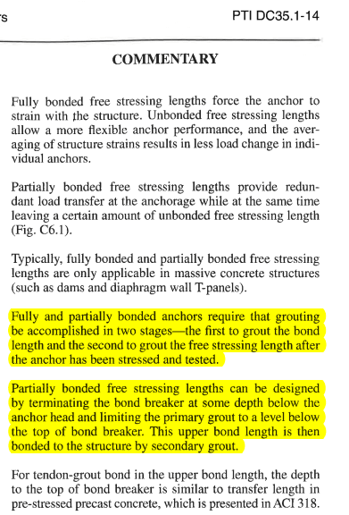

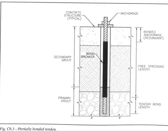

That's usually the response from the other side of the table. PTI has conflicting information regarding what they recommend. Upfront PTI says this:

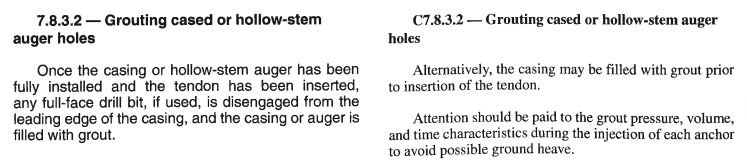

And later on they say this:
Not sure what they're trying to say.
But regarding soil nails, I'm holding the team to the standards provided in the latest soil nail design manual. If it says not to use the PVC bond breaker as it causes erroneous results, I'm sure as sh*t not going to let it happen, even if it's inconvenient when we talk about tie-backs. I don't make the standards, I'm just here to abide by them.
