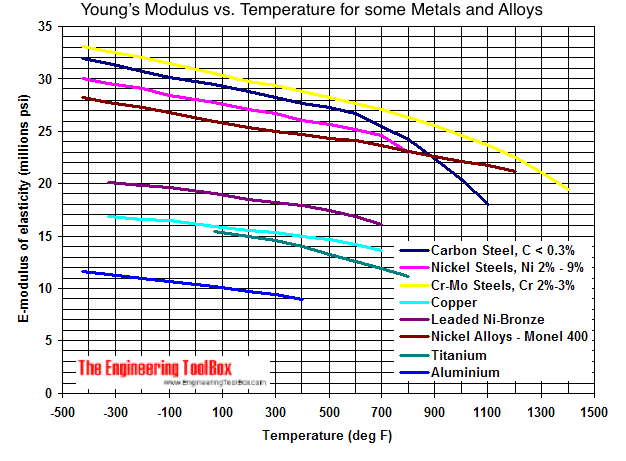

Hi
i need value of Ys for material sa-105 at 426 centigerade ... pls help me this is 166 or 165 mpa
does it Really matter ?
The sources that I would be checking would be the ASME codes I and IV dealing with the construction of process and heating boilers, respectively. Code VIII may also help as it deals with unfired pressure vessels.
Young's modulus may have more variation, which could have implications on support spacing - graph below for reference
