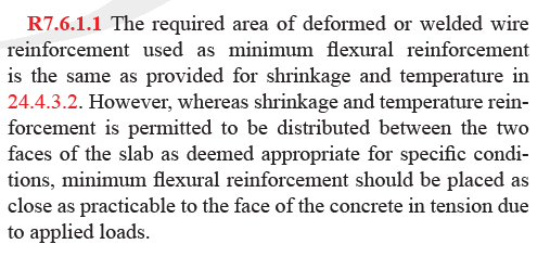

The ACI 318-14 minimum flexural reinforcement for foundations is as follows and is applied on each face (top and bottom) of the foundation mat.
