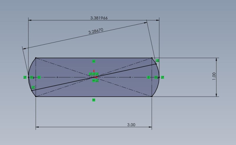

I'd like to clarify something about this tangent to tangent dimension...it is buried internally in a part, the only way to measure it is to section the part on a wire EDM...but we have a CT scanner that can xray these parts. That brings its own challenges.

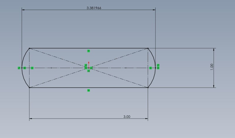

Regardless...my real issue is our in house team is using positional tolerances on these tangent to tangent dimensions, and the two opposing curves are not coincident. These tangent contact points are ambiguous, there are only two perfectly identifiable vector points that approve of this callout, unlike a plane to plane measurement there are tons of vector points that approve.
See attached drawing in solidworks.
Can you consider the tangent to tangent dimension seen below a feature of size that can accept a positional tolerance callout? I don't see how if only two perfectly placed vector points can approve this transaction.
Edit.....if you were to mic this dimension at the wrong orientation things could go all wrong, depending on your mic anvil sizes or whatever you are using....this is why I don't like a tangent to tangent positional tolerance callout, but maybe I'm just too green to see how this would be repeatable.

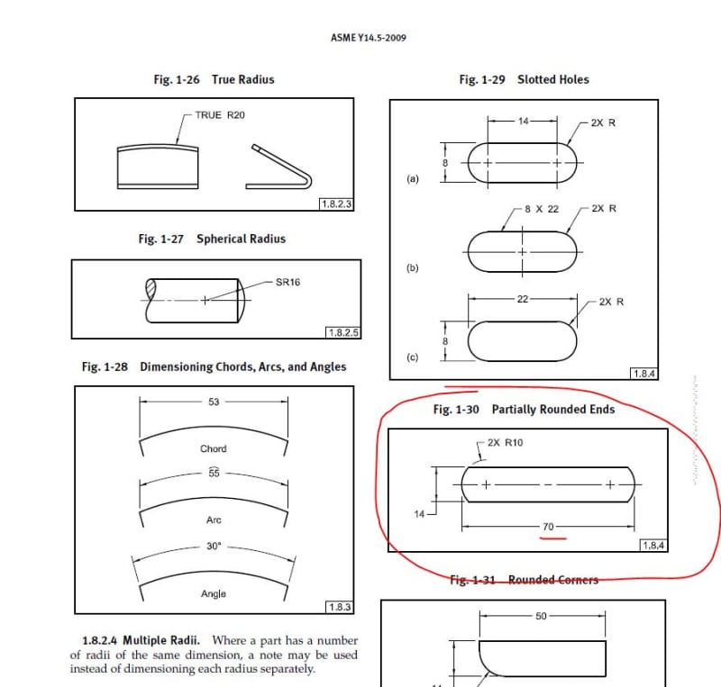

Here is an example from the standard 2009:

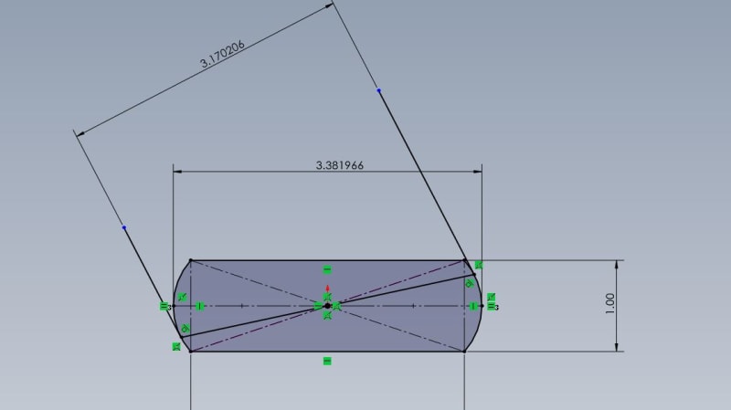

Here is a tangent to tangent incorrect measurement:
sendithard, I've worked with drawings where tangent to tangent directly toleranced dimensions were specified. The only useful interpretation for the size limits in such cases is that you have to find the measurement orientation that maximizes the distance reading, and this reading should be in tolerance. But, to be truly unambiguous, a profile tolerance applying to both rounded surfaces would be a better choice for specification. You are right that there is a problem with applying a tolerance of position to such tangent to tangent size dimensions, because the center plane is derived from the unrelated actual mating envelope, which minimizes the separation of the parallel planes that collapse on the feature, and it will be established at an unwanted orientation.
