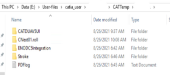

Hello,
At my company we are using CATIA V5 R28 and 3DExperience r2019. The CATIA-3DEXperience connector was installed for everybody, but however some of them has an Advanced Save with PDF command and some does not. Everybody is using the same connector version: 6.421.28.0. I tried to look for that command among all command list, but it is not visible to be able to add. How does that happen?
Thank you

Did you try to copy/paste your colleague's CATIA settings over yours?
Yes, and it works, now finally the user has this Advanced save with PDF command. So somehow the solution is inside of the CATsettings, which it seems may set up outside of CATIA GUI, because in GUI I could not find anything.
BTW another problem come up for the user. After the CATSettings copy the language is now German, user change to English, even though he set it to English, after restart everything is German again. And his OS is in English as well. But that is another topic...

Where are your CATSettings saved? On a server or on your PC? If they are somewhere on the network, are they overwrite according to some rules? Did you talk with your CAD admin? Normally this has to be solved and known by this person.
I am the admin. :) However not as deep as I should be in CATIA admin stuff.
Both the user and ref CATSettings are saved to the server side. The interesting is that if I just set back the user's original CATSettings then his language keeps being English, but in this case the mentioned Advanced Save with PDF is missing of course. I assume some kind of CAA was installed for some users and it may allow commands to not being in the "CATIA all commands list". This could be an explanation because the ENOVIA V6 toolbar -- in which this Advanced Save with PDF is in -- can be deleted by a normal user (the button is active), so the toolbar was made by a user or some CAA\macro. For example the 3DExperience toolbar which is installed by the CATIA-3DEXPERIENCE connector cannot be deleted (button is inactive), I guess because latter is an official application by DS.
Regarding to the problem where CATIA does not memorize the language settings I also guess some kind of rules given by the system which overwrites some settings to get it back to default. The user's machine is in Germany, but he has never used it with German OS. So it is still a misery why it works with his original CATSettings and why not with his fellow coworkers' settings, who is also in Germany, and he also has never used Windows in German. May a simple copy past of the CATSettings folder is not enough, some other things need to set up. I am digging deeper in these topic, I found some guides about it.
