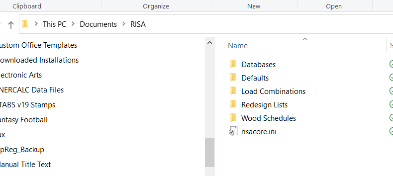

EAengineering07 -
Some thoughts:
1) Hopefully you have a copy of the v 11 install routine. If not, RISA may (or may not) be able to provide you with one. That's your best step if it's available.
2) If not, then I could probably help. Let's say you install RISA into the C:\Program Files \ RISA folder, this is a protected location for Windows. Therefore, RISA cannot use this for temporary files, or any files that the user can change / modify.... like databases. Note: that there are copies of all of these files there. But, there will also be a copy of those files in a directory associated with the user profile.
3) I can usually find these files under the Documents \RISA folder on the old computer. You should copy that folder from the old computer to the new computer in that same location.
4) I should mention that this isn't a "perfect" solution because it still probably means that you won't have all the registry settings that normally get set during installation. But, it may be enough to solve your problem.
