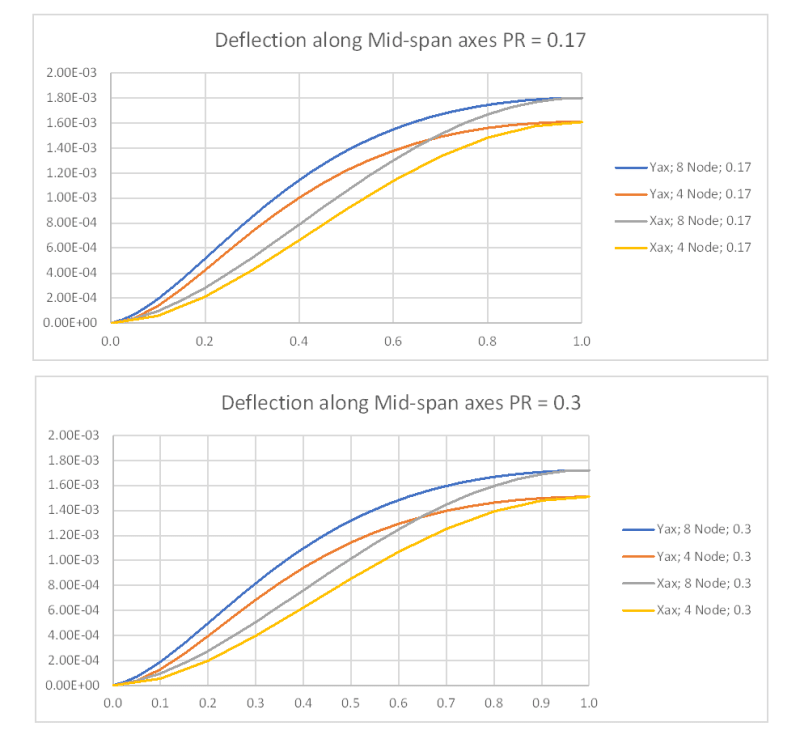

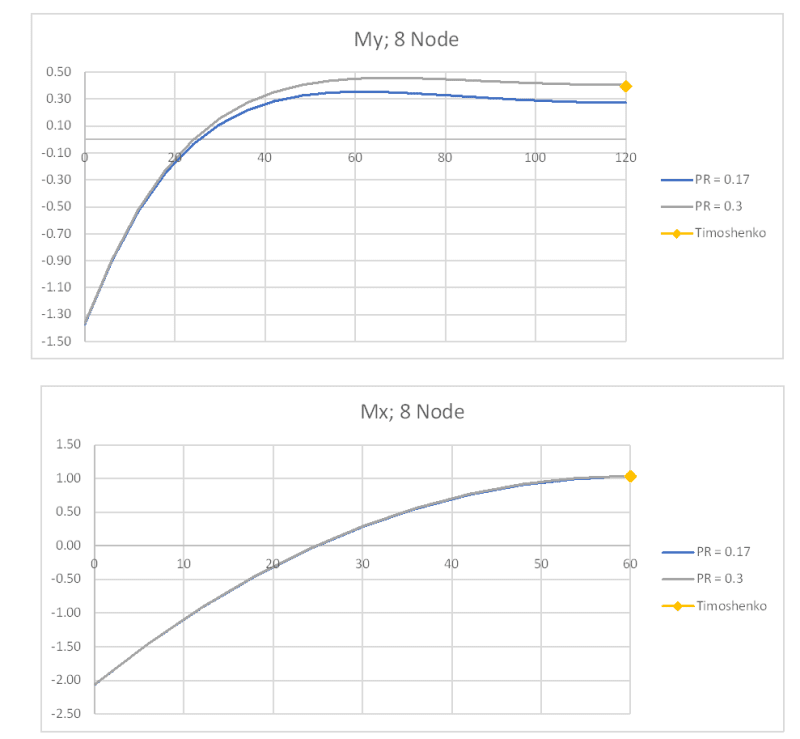

Some more background on the discrepancy between my results and Timoshenko for the long span moments:
Checking the Strand7 Theoretical Manual, it confirms that their 8 node plate element includes shear deflections, and the 4 node doesn't. Since the 4 node results are in good agreement with the Timoshenko deflections, and the 8 node results are in good agreement with nlgyro's results including shear deflection this suggests the Timoshenko numbers are correct for bending deflections only, ignoring shear strain.
For the bending moments, the Timoshenko table is based on a Poisson's Ratio of 0.3, and gives no adjustment for different values. Clearly (from symmetry) square plate would have equal bending moments in both directions, so there would be no adjustment in the moments for Poisson's Ratio. For a rectangle with side ratio of 2 though, the shape of the bending moment diagrams in each direction is very different:
Checking my results for Poisson's ratio = 0.3, the My (long span moment) is only about 3% greater than the Timoshenko value. I had previously compared the maximum moment, which occurs just past 1/4 span, rather than the mid-span value. This suggests that the Timoshenko My is a reasonable approximation for Poisson's ratio = 0.3, but the 0.17 My is significantly lower.
I have also plotted the midspan deflections along the x and y axes to a normalised scale, again showing very different shapes for the two directions, which suggests to me that there is no simple "exact" solution for rectangular plates:
In summary:
1) The proposed element size can give good results for both deflections and bending moments, but it needs a suitable plate element. The MITC4 element doesn't seem to give good results.
2) The Poisson's ratio has a significant effect on the mid-span moment in the long span direction, but only a small effect on the others (at least for the 2:1 shape examined).
3) Allowing for shear deflections has a significant effect, but for a concrete structure this will be minor compared with other approximations, such as the effects of concrete cracking, creep and shrinkage.
