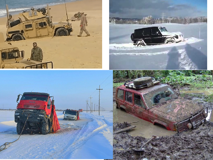

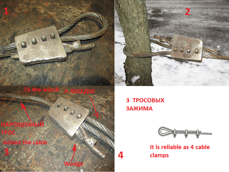

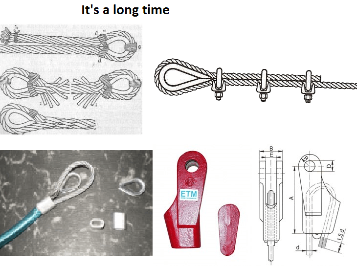

Sometimes the car must be pulled out of the sand, snow, water or swamp before repair. Sometimes, the length of the winch cable is not enough. We invented, made and used a wedge buckle to quickly connect the ends of the cables by a hammer in 1,..., 2 minutes.
You won't find it anywhere else.
Details in the message from January 12, 2020
