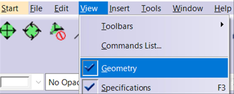

Model and features invisible in Part design but Visible in Assembly 1
vivekanandhss
Aerospace
Jun 23, 2023
My subordinate got this error suddenly while working on a CATPart.
Everything became invisible in the part design workbench. Only the spec. tree is visible and when we try to edit any feature, the options are visible around an invisible object. there is nothing in hidden space as well.
Also this is not an issue with selection of specification tree(shift + f3) or 'current body' option.
When i copy pasted the same CATPart to a CATProduct file then everything is visible.
Also i tried opening this CATPart in another machine. It works fine, everything's visible.
why is this happening in this machine(in part design)?
from "View" toolbar, make sure "Geometry" has a check mark next to it.
This can be toggled on/off in part/GSD independently from Assembly Design.
