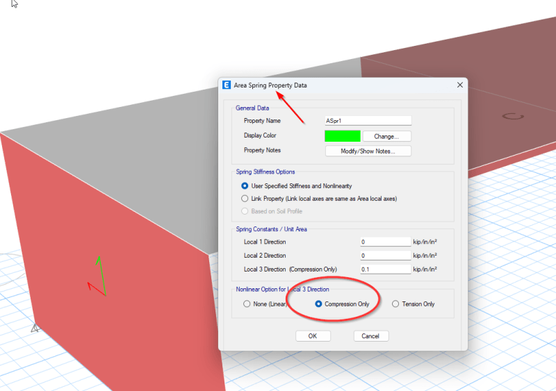

Etabs and SAP have an area, compression only support button. My understanding is that you assign this to your footing of interest and it will determine the soil spring stiffness based on the FEM mesh that is created.

Yes that could also work! The soil spring feature in ETABS uses the user defined stiffness property in pci (lb / in3 = lb/in / in2) which is essentially an area stiffness (the amount of force for one square inch to deflect one inch).
This stiffness in provided by the Geotech as the subgrade modulus.
ETABS then dumps this into the corner nodes by consider the tributary area of each node. So pci * in2 = lb/in (regular stiffness spring for each node).
So you could model, say, a "baseplate" with a high stiffness in the u3 direction and that would work as a roller too.
