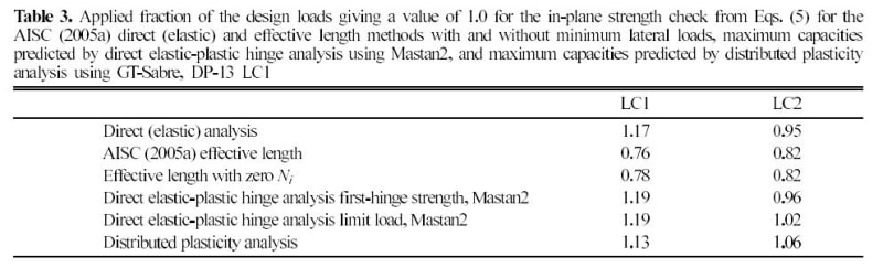

lexeng18 said:
However how do you know which method is applicable to any given project, or for example when the effective length method is not a good choice?
1) Clips below from the paper that I linked in my last post.
2) All methods are allowed so long as they cover the various aspects of stability in some fashion, so no limits there.
3) For a non-sway column loaded at its ends, K-factor is perfectly sufficient. Only go fancier if you're basically getting DAM on such columns for free from a global analysis.
4) For members in low aspect ratio, concentrically braced lateral frames, K-factor is perfectly sufficient. Only go fancier if you're basically getting DAM on such columns for free from a global analysis.
5) In the space that is rectangular/tiered building design, it's really moment frames where one may want to go with the more modern methods for reasons other than expediency. The first order amplification method is really a simplified version of DAM so, in this respect, their range of applicability is similar. Both of these methods consider P-DELTA and P-delta explicitly which tends to lead to the greater accuracy that is desired when both of those things are present in significant measure.
6) A truly wonderful feature of DAM is that it can be simply and uniformly applied, in a highly automated fashion, to situations of almost any level of complexity. DAM was purpose-built to play well with our FEM toys. My prediction for the future is that DAM will take over. I see first order amplification dying off entirely and K-factor being retained only for the simplest of scenarios.
7) For truly complex frames outside the range of rectangular/tiered building stuff, DAM really shines. It will be more accurate than many of the other methods and will be capable of capturing things like the tendency for one lateral element to brace or be braced by it's neighbors at various points in a structures load history. Additionally, the simplicity and uniformity of applying DAM make it a method that, in my estimation, inspires confidence in highly complex situations highly prone to designer error.

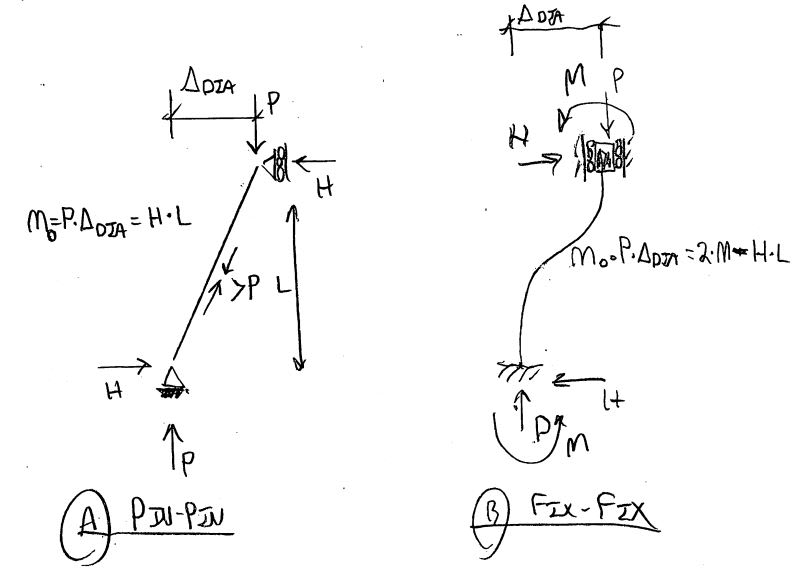

I do not believe the original designers paid any attention to the fact that the diaphragm deflection under wind or seismic forces warrants additional consideration for the interior columns.
I all but guarantee tat was the case.
lexeng18 said:
In my mind, if I imagine these columns under full axial load, then the top of the column deflects with the diaphragm under some wind load, how does this not cause a bending moment in the column equal to the axial load times the diaphragm deflection?
It absolutely does induce a moment. That moment is just expressed differently for columns having different end fixities as shown below.
In KootK's (A) above, i.e. pin/roller, no moment is introduced in the column, but there is a story moment PΔ = HL.
BA
