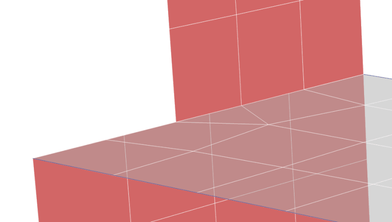

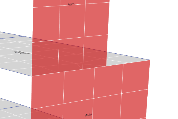

Just wondering how you guys model walls that don't line up in 3D FE model like ETABS?
See below as an example. As you can see, the meshes that don't line up. And the slab meshes just match above. So, how do you normally separate the walls below into two or do you prefer manual meshing?
The reason I am reluctant to divide the wall shell into multiple pieces is it will create too many wall panels in the model.
I know there is a auto edge constraints option in ETABS. Do you recommend use this function but not divide the wall shells?
I don't think it matters that the meshes don't align because ETABS uses edge constraints to deal with this.
So just model as one wall above and one wall below with normal meshing, no need to divide shells into smaller pieces as long as auto edge constraints are assigned? I thought even if edge constraints are assigned we still needs to divide shells?
I don't believe there is any need to divide the shells. You can always check the deflected shape to ensure the edge constraint has been applied correctly.

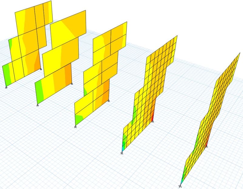

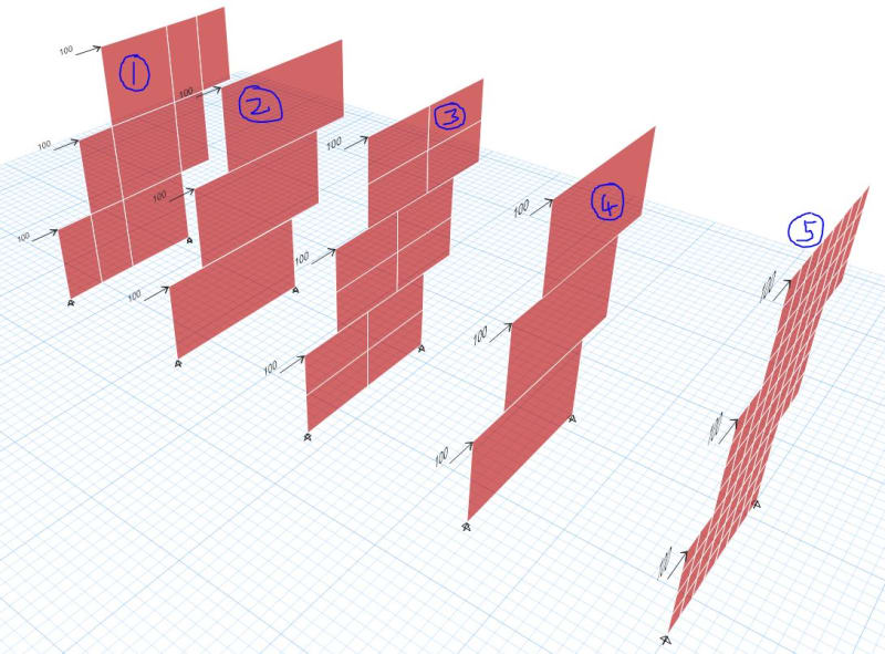

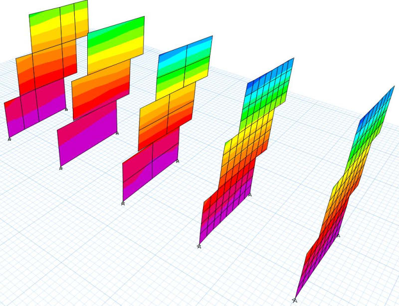

Few different options below. All have Auto Edge Constraints.
1 - course but correct manual mesh with all joints noded out
2 - no meshing whatsoever
3 - finer mesh but not noded out correctly. This would rely on AEC.
4 - Automesh to 1m element size
5 - Manually meshed to 1m element size
Notes:
- I don't like that the program will show literal airgaps for deformed shapes when relying on mesh that isn't noded out and Auto Edge Constraints.
- I don't like the discontinuous stress diagrams you get with poorly manual meshed walls and AEC.
- There is over 30% increase in deflection with a fine mesh as opposed to no meshing at all.
Deflection
Vertical Stress
Great post. Do you have the section cut forces from each?
