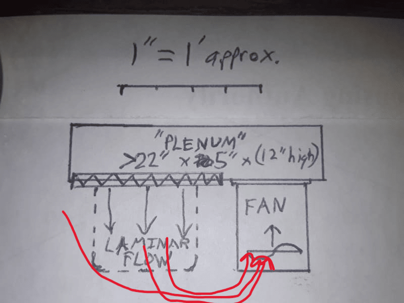

I need a more compact version, using the same cheap filter and fan. Instead of the tote I have a section of salvaged 12x5" rectangular duct. The filter is 11.4" x 13.4" so it will fit perfectly with a piece of that duct turned on it's side. I'll use a 6" round duct take-off and a support bracket to mount the fan outside the duct, next to the work space and blowing backwards relative to the filter flow.
The filter needs even pressure to produce laminar flow. Based on mechanical engineering discussions I overheard during my years of work I suspect the space in the tote could be considered a plenum, and that plenums need to be properly sized to produce even pressure. I don't know how to do that but I've gathered some basic info below.
Original tote "plenum" volume calculation:
66 quart tote - (7.3" long x 6" dia fan) =
2.2 cubic feet - 0.1 cubic feet = 2.1 cubic feet
Minimum possible "plenum" volume using 12x5" duct:
min length = 13.4"(filter) + 1/4"x2(for caulking seal) + 8"(flange dia for 6" take-off) = about 22"
22" x 5" x 12"= 0.76 cubic feet
Sketch of proposed compact hood in plan view:
The filter and fan would fit on a 22" piece of duct but it may need to be longer so there's more clearance between the work space and the fan, or to get a larger volume "plenum."
I read that the higher the flow the bigger a plenum needs to be to have even pressure. According to the original designer this filter needs about 200-250 CFM. He studied the laminar-turbulent transition and Reynold's number, which is all over my head.
How do I calculate the minimum plenum volume for a given flow rate?
What are the design guidelines regarding plenum geometry?
If I'm on the wrong track and these calculations aren't necessary that would be really helpful to know too.
I'm also concerned the fan's intake could alter airflow in the work space. It's easy enough to change later but do you think I'll need a 90 degree bend and/or short piece of round duct to prevent that?
Any advice will be appreciated, and thanks for reading all this!
You should be okay with your proposed design and considering you have a variable speed motor to adjust for the laminar conditions. Considering you have an axial fan, the velocity will most be diffused by the back wall, beyond that you are creating static pressure. Will you have a perfectly even pressure gradient? probably not, but I doubt you did in the other arrangement either. Even though you stated this fan was not for static purposes, the vendor indicates it can develop 7.65 mm-H20 of static head, which based on your former design performance was sufficient for the filter. I am assuming the design goal is to have a stable volume of filtered air to perform your work in but based on the proposed design I would have a slight concern that a secondary flow stream could develop, disturbing your work area, so it might be worth ducting the fan inlet in a different direction.
I'll probably just build it and then see if I need to duct the intake.
