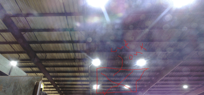

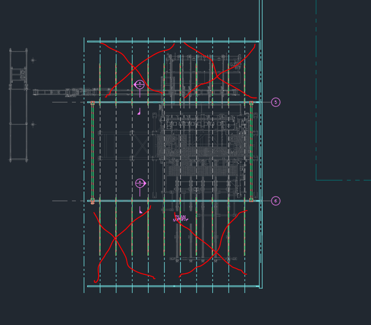

canwesteng, from the pics I have there appears to be rod bracing in the roof at the adjacent bays. But oddly doesn't seem to be wall bracing in these bays
I recommend walking through the lateral load path from the end walls to the vertical bracing. Start at the end wall girts, which flow wind load into vertical wind columns. The reaction at the top of the wind columns will push against the roof plane. The purlins in the roof plane will be loaded axially and bear against the horizontal roof truss bay. The horizontal roof truss will have tension members (rods/cables) and compression members (purlins). The horizontal truss will span across the building and have will have end reactions at the longitudinal walls. The eave struts act as a collector to distribute that horizontal truss reaction to the vertical braced bay.
I think once you study that load path, you will find that removing the purlins in that bay between the horizontal roof trusses will not interrupt the load path. The load essentially flows around that roof bay when the horizontal trusses take their reactions out to the eave strut collectors. Therefore I do not believe the existing purlins will see any additional axial load.

Note that Pre-Eng building will use multiple bays of roof bracing often depending on the building length. If the building is 200' long, there might be 3' bays with roof bracing, each taking 1/3 of the lateral load down to the eaves as bones described. The remainder of the load is taken through the roof purlins and distributed down the building to the next braced bay. If you remove the purlins, you will have extra load that needs resolved through the frame bending. I would consider adding roof bracing on either side of the opening as needed to help limit the load.

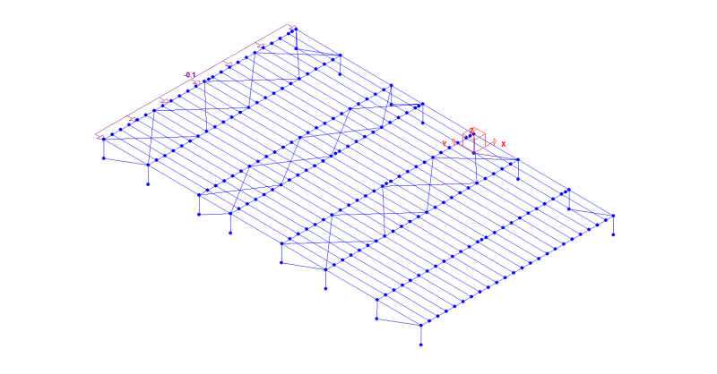

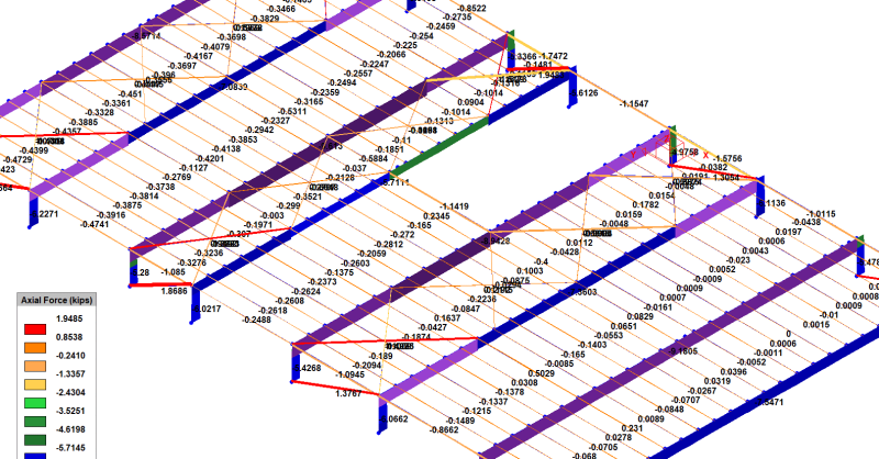

Thanks for the explanation of that load path bones. I haven't worked very often with PEMB's so it is very helpful to see how the load is travelling through them. I see how the horizontal trusses would help transfer most of the load out to the eaves, but there must still be load travelling through the purlins that must be accounted for especially right close to the eaves. I ran a really rough model to see how this would work and I got more load in those outer members once the purlins were removed
Now I now this load is technically not applied correctly, and I also have a limited software license that is nota able to model tension only bracing or run non-linear analysis, but I thought this would in general still be the same situation regardless of how accurately it was modelled: excess axial load and bending to account for all around that opening

So it has 4 bays of vertical bracing but only 3 bays of horizontal bracing?
straub46 made a good point about the 1/3 lateral load sharing assumption being impacted by the purlin removal. But I do think that if you apply the windward and leeward components separately, that should alleviate the opening effect to some degree.

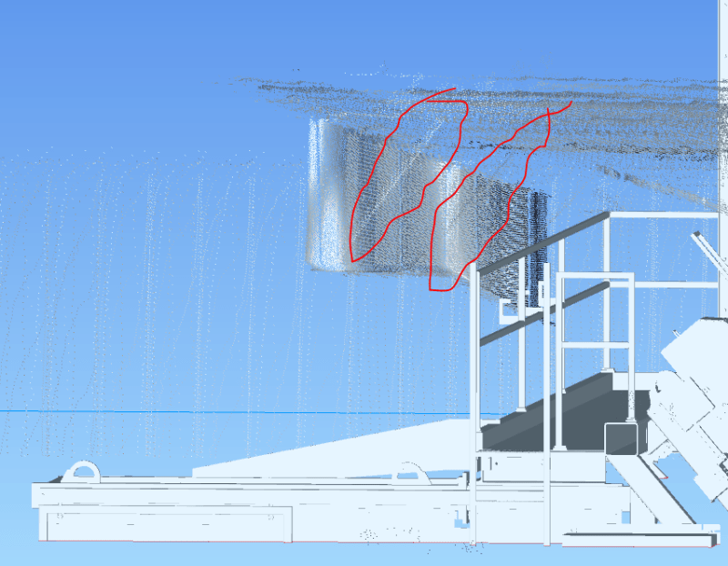

There is clearly a 3D laser scan. I have extracted information from those before. Were you provided that information?

ya the number of bays and bracing are not accurate because I only have some pictures and a semi decent scan of some interior to go off. It is a 500'X260' building so probably like 16 bays. I was just modelling a few bays with some random bracing to see what the load path would look like in general. I am not able to go to site and have no drawings of the original building. Like I said the company I work for has the old school mentality of just getting stuff done without any need for legitimate engineering, so I am trying to reinforce a building I really have no info about, so I am just trying to make worst case scenarios and be extra conservative.

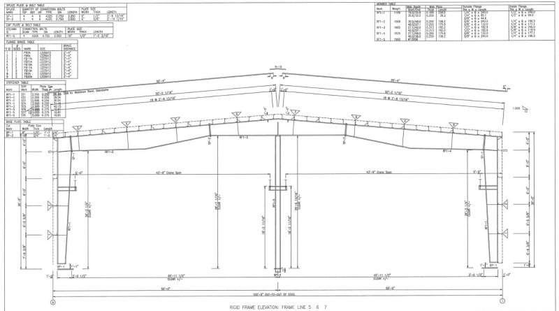

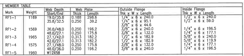

Below is a typical pre-eng frame you can be provided by suppliers. This is new, so one can expect every step is scrutinized to save pounds of steel. If you have an old building, the amount of automation was much less, so there can be some fat in the design. Below that you can see the frame member sizes. It is ridiculous. These work if built as designed, but I have seen endless ding dongs take out things they should not. We had one client that wanted to take out some flange braces for a crane. They lost their marbles with the new beams required to allow them to remove a flange brace from each bay line.

As for the scan data. I do have access to it, but it does not give me enough information to be able to model this whole building or see all the details. I have a decent scan in the area that this roof is being opened and it does look like there are a set of one sided flange braces that will need to come out. all of the purlins are being reinforced and I was thinking I could just move these braces to the other side of the frame and attach them to the reinforced purlins.
You can get the basic frame geometry from the scans quite well. We use Revit for this quite frequently. It works very well with point clouds. You need to get your view plane set to the frame lines very well, and then play with your depth settings. With some practice and thought how the scanner is working, you will be able to decipher what many points are. Your view depth is very large in the image posted, so you cannot figure out much with that. If you do not have any software, it will be tough. CAD does not work great because it lacks view depth control. If you have the full version of CAD, you can extract sections along any line. The scanner will have collected millions of points. The problem is things are in its view path. It still collects data, but you end up missing what is important to you. You have to dig thru the data.
If you able to post a link to the point cloud I would take a look on my own time. You are clearly trying to do what you should.
Thanks Brad805, that is really kind of you, but I will go through the scans some more and see if I can't come up with a half decent model to estimate some loads myself. It's just super time consuming because I am working off a laptop. I don't actually know who this scan belongs to so I don't feel comfortable sharing it.
