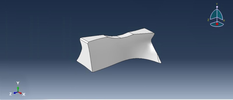

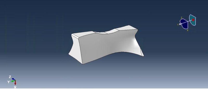

Dec 7, 2020 #1 Etienne17 Mechanical Dec 4, 2020 6 0 0 DE Hello everyone, I'd like to change the coordinates system of the following picture...: ...as follows: Is that possible ? How to do that ? Thanks for your help, Have a nice day.
Dec 7, 2020 #2 FEA way Mechanical Nov 13, 2018 4,894 0 36 PL You can rotate this part with respect to global CSYS as you wiah using tools available in the Assembly module. Upvote 0 Downvote
Dec 7, 2020 #3 Mustaine3 Mechanical Feb 25, 2015 1,645 0 0 FR Why do you need that? Usually you can assign things and also visualize results in a local coordinate system. There is rarely a need to rotate the instance in the Assembly module. Upvote 0 Downvote
