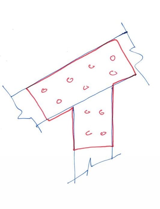

I am attempting to design a moment connection for the top-chord-to-post connection for a timber truss (diagram attached). I realize that this is a connection best avoided; however, I am trying to accommodate the architect's vision. The design is inherently unstable if all connections are pinned, so I modeled it with fixed connections at the locations mentioned above. I've done a few other timber truss designs, but none as nasty as this one. I'm thinking of trying to use steel dowels epoxied into the members, but I'm having trouble finding design values (though I doubt I'll be able to develop the loads needed).
The connections I've considered so far-- straps, bolts, plates, etc.-- I don't believe will give me the needed fixity. I also realize that there will be further design considerations if the epoxied dowels are a viable option, such as moisture content, shrinkage, etc. Also, other geometry options would ruin the desired aesthetic... it would be so easy if I could push the bottom chord up a couple of feet...

Maybe something like the attached sketch would work for you. Steel side plates each side (continuous plate across the joint), either thru-bolt or lag screw. You can extend the plates as long as you need to transfer the force from wood to steel, then the steel plates do all of the heavy lifting at the joint.
That's actually what I had originally designed, and then I was told that I couldn't consider plates and bolts in that configuration to be a fixed connection... I understand when you only have two bolts that a slight difference between bolt diameter and hole will produce movement, so I guess the same applies to a larger bolt group, to a lesser degree?
It was recommended that I try the dowels and epoxy or a bucket connection. Or maybe I'm over-complicating it?

I suspect you'd need more than 2 bolts per member - strength considerations aside, you can provide as many as you feel necessary to get a rigid connection. Any bolted connection will have some play in, how much movement can you tolerate? If you use lag screws, that will eliminate any play in the fastener to timber interface, and the holes in the steel should have to be 1/16" oversize for the lag screws.
At first glance, it looks stable to me without moment connections but maybe I am missing something. In any case, if you absolutely need a moment connection, my first choice would be the plate idea as suggested above. The steel plates will be significantly stiffer than the wood members they are attached to. My next choice would be a sleeve or tube around each member in the connection (similar to the [plate configuration, only with tubes).

Turns out my original assumptions about the need to treat the configuration as a complete truss system were incorrect, so I am looking at it instead as top chords acting as cantilevered beams to take the point load from the ridge beam and bearing onto the cross beam below, with Simpson concealed beam ties and concealed joist ties. Thank you everyone for the input! I've got a lot to learn...

One other thing to keep in mind - when you introduce large steel plates bolted like some of the sketches above, the connections will likely develop cross-grain tension and split (due to the extreme rigidity of the steel compared to wood coupled with the wood shrinking), rendering the connection useless. The NDS sets rules for max spacing between bolts in adjacent rows on the same steel plate and I believe AITC has a document discussing use of connection plates like what was sketched above (link is here:

No worries - let's say you have 2 lines of bolts 9" apart on 1/4" steel side plates connecting a glulam beam to something else. An average value for shrinkage perpendicular to grain is about 1%. The distance between the bolt centerlines in the wood will want to decrease by 1% x 9" = 0.09" as the wood dries out. If you specify standard holes in your steel plate, there will be roughly 1/16" = 0.0625" available for the distance between the bolts to shrink (the steel will not shrink) without causing any restraint. When the distance between the bolt C/L's tries to decrease more than 0.0625", either the wood or the steel has to give, and since the crossgrain tensile strength of wood is on the order of 5-10 psi (think about how easy it is to pull strips off the edge of a 2x4 you pickup from menards...), the wood splits at bolt line and you go from having 2 (or more...) lines of bolts in a solid member to 1 line of bolts in a cracked wood section - in other words, once the wood cracks, your connection is useless.
Take a look at 2015 NDS Tables 12.5.1F and Figure 12H (NDS is free to access online). It limits the max distance between outer rows of bolts on the same plate generally to 5" or 6", so the max shrinkage (1% x 6" = 0.06") is roughly equal to the "slop" that is standard in fabricated steel connections.
Similar restraint and cracking problems develop when you try to use rigid (i.e. steel plate) connection plates in joints - i.e. at a truss panel point - there will be some rotation in the joint at all the members, but if your steel plate is too long it will restrain the rotation and cause the bolts to try and resist crossgrain tension resulting from secondary moments that develop and your connection will crack. Long story short, eccentricity in wood is bad!
