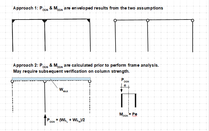

I am going to try to explain the two approaches that make the connection "Semi-Rigid". Why different, both are valid and conservative, the real difference lies in preference of the designer. The first approach is more modern and efficient (in certain sense) due to the advancement in both computing power and software. The second approach predates to the invention of computer. Hope this quells the argument between people in different campus.
I come up a good phase to distinguish these two approaches: "A Rich Man's Toy vs a Poor Man's Cadillac".
@human909, @CanPro - I understand your concerns about the column, However, the approach I take is to look at the element's collapse mechanism.
Lets say that the beam end-moment is high (higher than the bending capacity of the column) and connection was designed to be very rigid as to resist this couple (I find this highly unlikely because localised failure of the column will likely govern the connection design). Connection design usually checks three components 1. localised failure of beam parts (flanges/web) 2. localised failure of column 3. failure of connectors (end-plates, bolts, welding). The weakest of the three governs the capacity of a connection. If you have a small column that cannot resist high bending then this will influence/affect the connection capacity.
The column end yields due to bending, but the column doesn't collapse. I expect the column flanges taking the beam end-moment to gradually yield but once the column flange starts to yield the connection becomes more flexible (due to localised failure of the column component of the connection) and less moment is transferred at the ends.
I can be proven wrong. The behavior I described above is based on theoretical behaviour of steel structures, it is probably best to make a scale model of this and test it, ala mythbusters. I'm a big fan of 'testing' but our industry usually leaves this out to people in the academe. To this I remember the quote "Tell Me and I Forget; Teach Me and I May Remember; Involve Me and I Learn"
The trouble with a plastic collapse mechanism is that it must be able to develop without generating any catastrophic / brittle failures en route to that collapse mechanism. And the failure that usually messes that up in steel is buckling, in this case overall column buckling. If the column would buckle as a result of combined flexure and axial load before the connection stops absorbing moment, then it would all be for naught. I do acknowledge that there are practical things that would tend to limit the likelihood of such a failure, including:
1) Inherent connection flexibility.
2) The column's tendency relieve connection moments as flexes.
3) The tendency of a pin-pin designed column to exhibit significant rotational restraint at the top (0.7 < K < 1.0).
4) A column's tendency to shed its flexural stiffness as the axial load imposed upon in approaches the Euler buckling load.
Most of this stuff is difficult to estimate but it is for these reasons that, for many practical beam and column proportions, I will assume the connection to be pinned but moderately eccentric with respect to axial load delivery.
