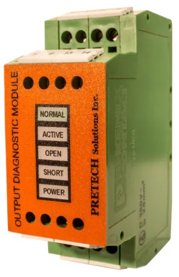

Thanks everyone! Update...I've gotten back some information from the company referenced earlier (PRETECH). This looks like the easiest solution....basically turn key. The engineer explained that their Solenoid Coil Monitor works by sending a small ac current through the wire and solenoid at all times. By doing this, it can pick up differences in inductance/resistance even if the resistance of the coil is very low. Then, it has an internal relay that switches over to power the solenoid with whatever voltage you provide. I looked at the Productivity 2000 as well but the output ratings were too low (0.25A) and I don't think this one detects for short circuits.

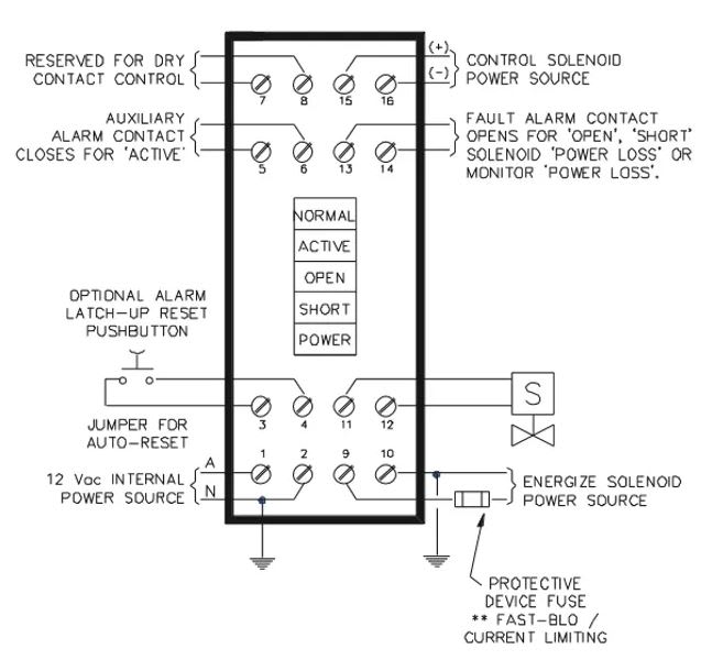

We've worked it into our design and so far the customer is happy....meets their requirements. This was the wiring diagram of the unit used. The only down side is you have to provide 12Vac. Thanks for all of the help and interesting discussion!
