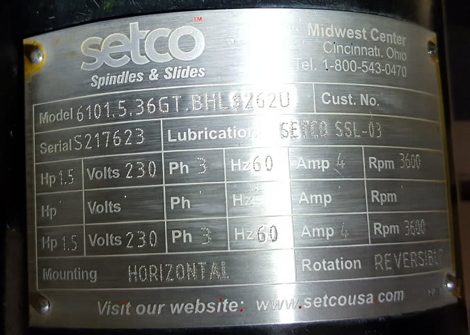

The motor name plates on ~20 "identical" motors are the most confusing poorly labeled bunch I've ever seen.
They thought they'd bought all the same units yet most are 4A FLA and one is 2A FLA and one is 1A FLA.
Here's an example of the plates:
Why two lines identical??
Some have the first line the same and the last line states:
230V 120Hz 7200 RPM
Others state the same first line and the last line states:
1.5HP 460V 60Hz 2A
Head scratching.

Isn't that a synchronous motor? 3600 RPM @ 60 Hz points to that. Then the VFD may be special and not the standard plain vanilla. Lots can happen then. If feed has stiction and doesn't move for a few seconds - then you get a lot of sudden feed and that usually means problems like uncogging and such. Strange that you didn't get an alarm...
Gunnar Englund
Spindle motors like this are now often IPM (Interior Permanent Magnet) or SPM (Surface Permanent Magnet) motors, collectively referred to as PMAC which because they don't need induction to the rotor, are in fact synchronous. There is evidence on Setco's website indicating that they use Fanuc BiS-B Series motors which are offered in both of these types, on their motorized spindles for CNC machines. If not the Fanuc, they likely used something similar.
They (PMAC motors) cannot be used without VFDs, but at the same time, not all VFDs can run them, it requires a highly complex control algorithm and often times a specific motor must have a specific drive. If the drives you are looking at were the original drives used by the OEM, chances are they knew what they were doing and used a VFD capable of powering their PMAC motors. If not, and someone swapped out that drive not knowing this, you could be in trouble. Given some of the things you meantioned about mounting etc., I'd suspect these are not the original drives. If you post the make and model of the VFD I can probably tell you, I've had to investigate who is and is not capable of running PMAC motors for some of my customers.
The reason for the different nameplates is because they will often do what I referred to above as the "double voltage trick". When you need to run at speeds above the motor base speed, what you do is to use a motor rated for 230/460V, strap it for 230V, but use a 480V VFD fed from 480V and PROGRAM the VFD to put out 60Hz at 230V. That way when you increase the frequency above the base motor speed, in this case 60Hz, you can keep increasing the voltage with it, maintaining the V/Hz ratio that the motor was designed for so that are not losing torque. So you can get full torque at 2x the base speed. In YOUR case because it sounds as though you don't really NEED all of the available torque anyway, they are likely not doing that trick, they are knowingly weakening the motor at 80Hz, but it's irrelevant because you don't even need that much torque anyway. So they can use any motor off their shelf for this, hence some are 230 only, some are 230/460, some are marked as 230V 120Hz, it wouldn't matter so long as the VFD is programmed correctly for each motor. That may be an issue as well, for instance if they pulled one VFD off of one machine and put it on another one that had a different motor.

Your second example is likely a motor run into field weakening, which could cause stalling. It could also be a dual voltage motor 115V/230V that is connected for 115V and then run on a VFD that produces a V/Hz pattern that reaches 230V @ 120Hz. What was the HP on the second line?
Your third example is likely just a dual voltage motor.
After seeing that, you should investigate further to figure out exactly what is there for both the motor and VFD in the applications that are giving issues.
Typically, the VFD is programmed for 460V and 120Hz to maintain the V/Hz ratio up to 120Hz when running a 230V motor. This will double the motor HP at 120Hz. These settings usually set the knee point where the voltage quits rising with frequency, so setting 230V at 60 Hz would mean the voltage stops rising above 60Hz.
I've also seen a VFD programmed to 575V @ 75Hz used to extend the full torque speed range of a 460V motor.
